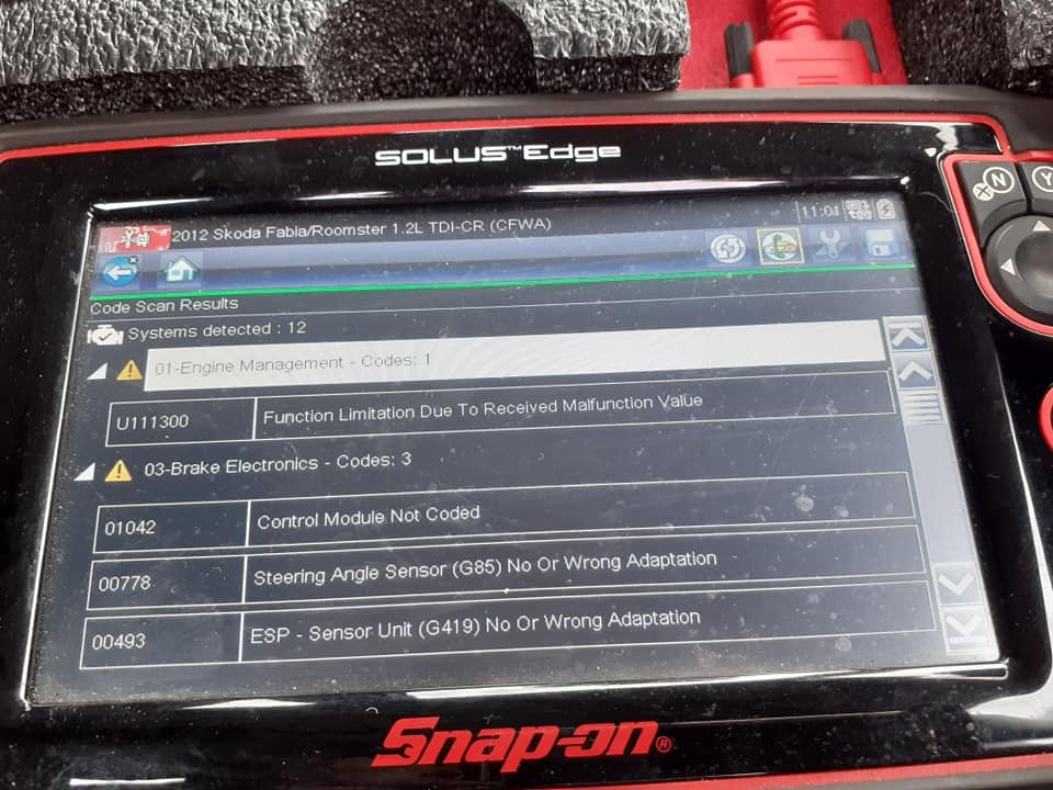

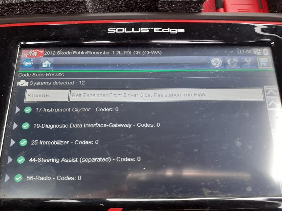

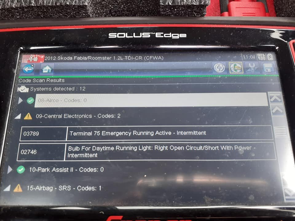

so i have a Skoda Fabia 2012 TDI iv took it to my local garage and its come back with 12 errors  i have recently had rear brakes, pads, bearings and a new tyre and this is when most of the problems  started  i have booked it in to a VW specialist tomorrow is there any of the error codes that can be easily fixed ? and the codes that cant be fixed will it be expensive ?

Airbag fault - Probably needs a seat belt reel
Central electrics - Check bulb connections
Brake fault - Code control unit and carry out basic settings/adaptation
Nothing particularly expensive or difficult to sort there.

Thanks for the response i have had it to a Skoda specialist twice and they said they cant clear the codes and it need to go through a OSD scan from Skoda its self  what ever that is
Edited by popoff10
ODIS, that’s the dealer equipment.
Probably cant clear the code as there is a fault that needs to be fixed first 🙄
