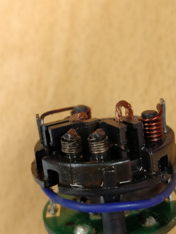

This is well known issue and main reason, why electric struts motor will fail is water and humidity passing the sealing. Often electric motor brushes sping will be rusty and broke, also electric circuit board will fail. I´m in progress of compiling video tutorial of repairing electric struts, but it´s very difficult to find brushes sping spare parts. I looked cordless drills motors spings, but I haven't found the right one.
I´ll add here my video of rusty brushes springs:
https://1drv.ms/v/s!ArqD60L2XvsyhRVc41SOqZLmAgkv
Edited by Lutz
My springs were rusty but not broken. Brushed them of and lubricated Them so now they move freely. The electric rotor is also rusted and doesnt move freely. Is it possible to remove the rotor?
