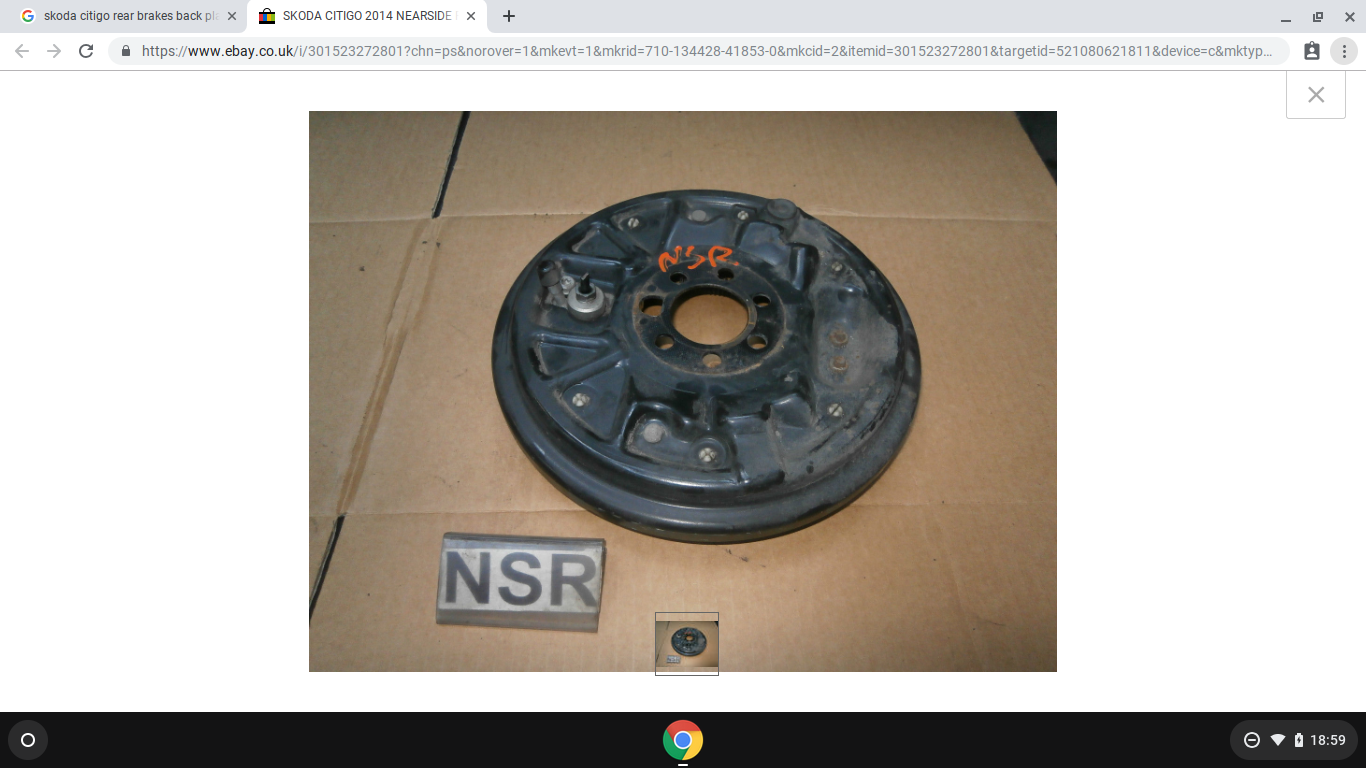

I don't know what I should look at that topic. But I do know this is about Citigo. No sliders of any kind. Brake shoes slides against back plate.
@Emil
Does the back plate have no nylon inserts or no pressed raised bits ?

Indeed, some drum brakes do have teflon (usually) glides to better locate the shoes as they travel outwards to the drum. They are press-in circular flat disks, located on the back-plate.
Although they can wear, I can't see how they would cause hard binding as described in the OP, and neither can I see how lubricating teflon/nylon glides is useful.
If they are fitted on Citigo drums - and as mine is brand new,  I won't be checking any time soon - then if you disassemble the drums, and  if the glides are there and not smooth, I, for one, would buy new glides (for a few pence on the scale of things) and replace them. Like anyone might for anything worn, once you are arsed to disassemble something...

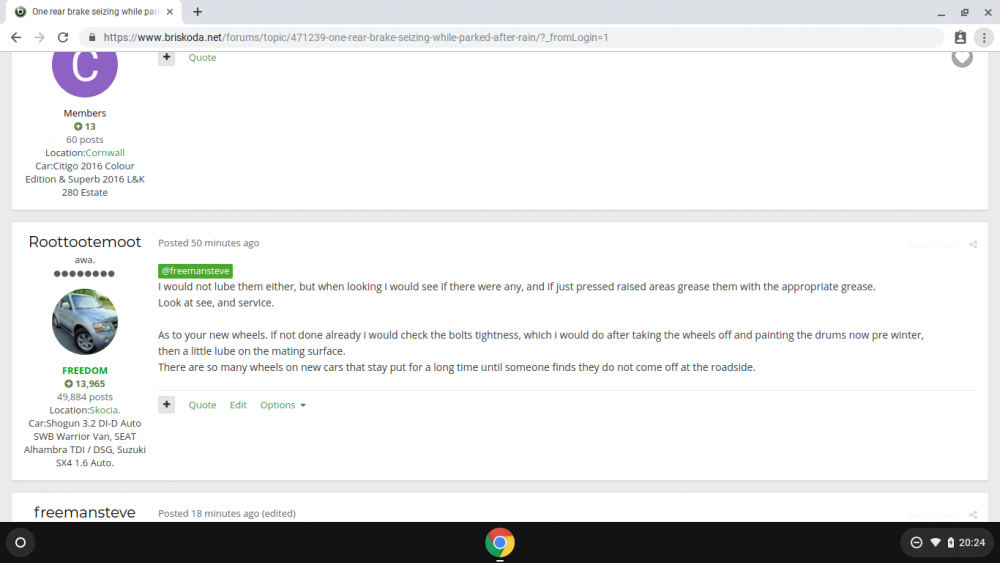

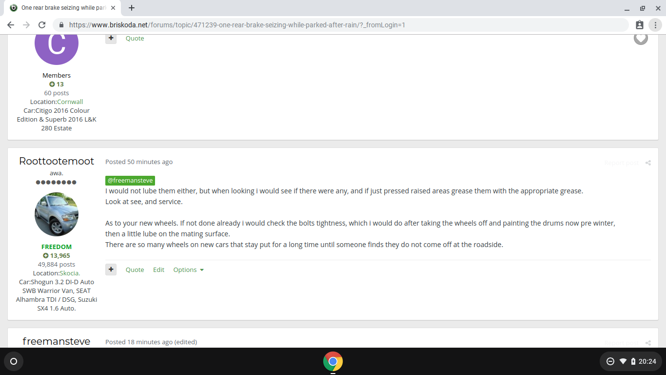

I would not lube them either, but when looking i would see if there were any, and if just pressed raised areas grease them with the appropriate grease.
Look at see, and service.
As to your new wheels. If not done already i would check the bolts tightness, which i would do after taking the wheels off and painting the drums now pre winter,
then a little lube on the mating surface.
There are so many wheels on new cars that stay put for a long time until someone finds they do not come off at the roadside.

"I would not lube them" & "grease them with the appropriate grease"
This could be confusing! I assume you meant any painted metal protrusions not the teflon bits. Frankly I would never grease the surface of backing plates, but if you know it fixes a problem, then fine!
Edited by freemansteve
@freemansteve  Certainly is as you edited what was posted after your post.
Maybe only if you are easily confused or do not know one grease from another. Or smearing lightly.
If in doubt leave well alone.

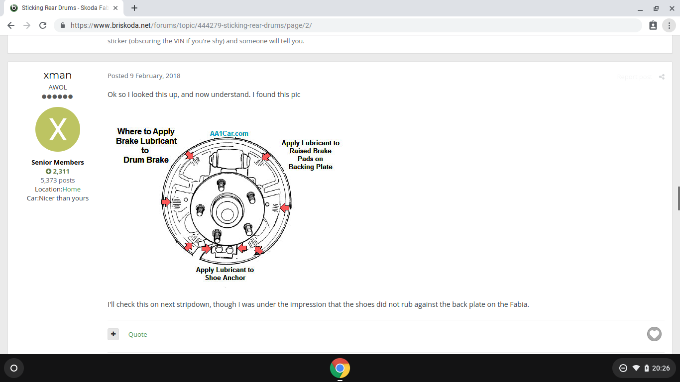

From the link i posted from the Mk2 fabia thread regarding the Sticking brakes and then the discussion on servicing drums, as some of us were trained to while serving our apprenticeship. In Motor Engineering.

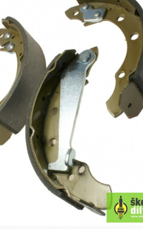

This very  common problem is down to a seizing handbrake actuator arm attatched to the trailing shoe that is used to apply the handbrake.
Its the long silver lever in this photo.
Corrosion between the lever and shoe support and the pivot builds up over time and with little movement to clean it because skoda and their techs insist that 2-3 clicks is the correct handbrake adjustment, so in time it gets stiffer and stiffer to move and will seize/stick when it gets wet and a little more corrosion. The return spring attached the handbrake cable at the bottom of the lever is too long, so is never straight and so too weak and flimsy to push a stiff lever back and release the shoes.
It needs cleaning/lubing/exercising, best if you can strip it and do it properly.
Loosening the handbrake cable to 4 - 6 clicks can help as the lever moves more and wipes itself clean(er).
Glide pieces are shown as item 8 on this ETKA diagram for Citigo, so I think they will be there https://skoda.7zap.com/en/cz/citigo/cit/2013-727/6/609-609020/
They tend to get coated in rust and brake dust and blend in with the backplate, so most people don't realise they are there.
Their presence is given away without disassembly by the little four-segment retaining clippy bits sticking out on the visible side of the backplate as in roottoots photo a few posts earlier. 3 per shoe, 6 per side.
