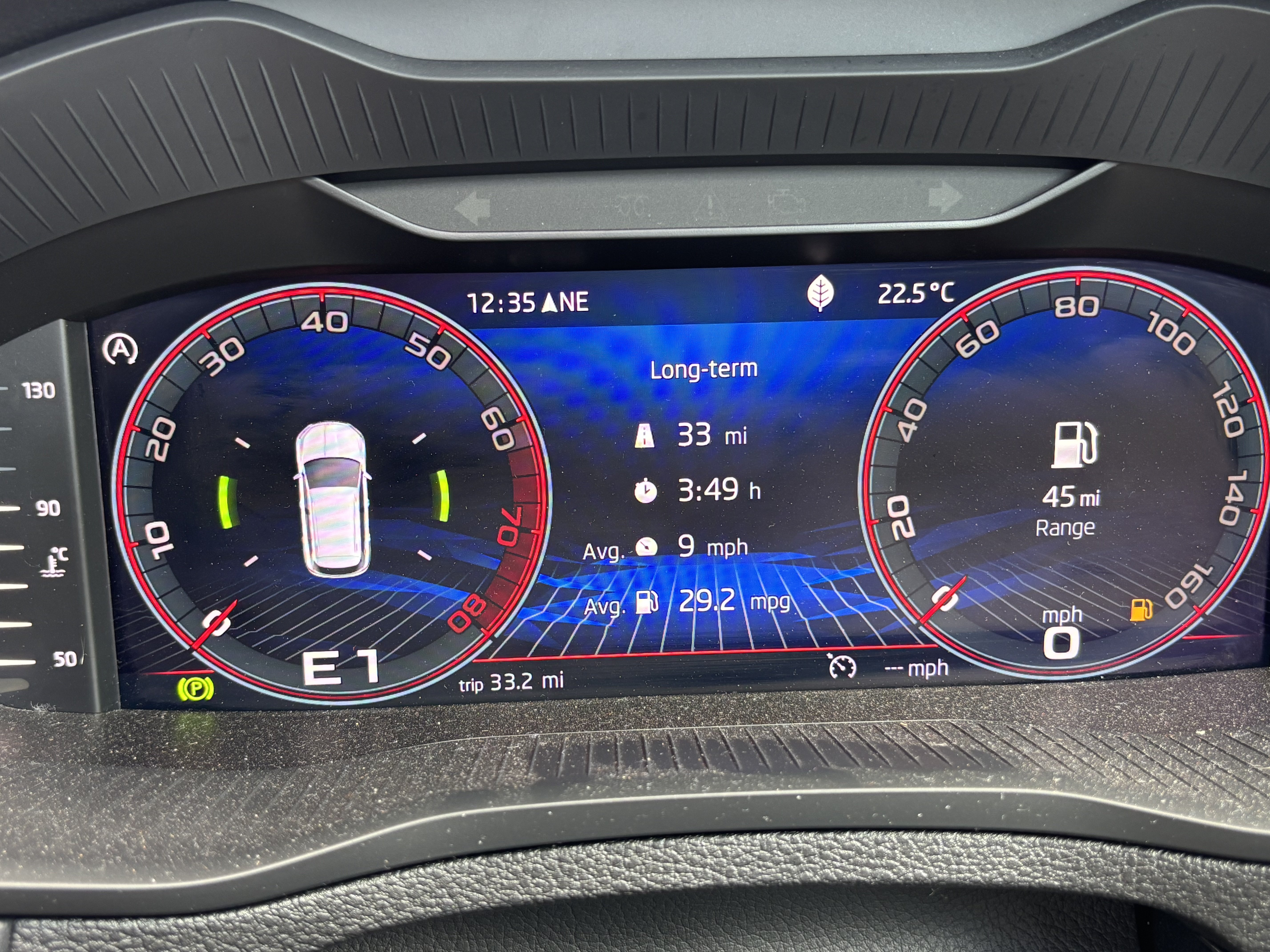

Anyone tried changing Display Depiction for dashboard? 8 versions but only 1 active. Can’t activate the rest. Obd11 with SFD unlocked.
