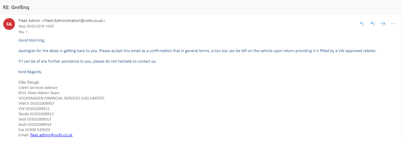

Don't panic, I was in the same situation a couple of years ago.
The line from Skoda Finance was that as long as the car is returned to them in the condition it was given to you, all will be good.
On the 2016 MkIII Octavia I had on PCH, in order to fit a towbar the bumper needed to be cut, so Skoda Finance said I had two options at the end of the agreement, prior to returning the car:
1) Remove the towbar and replace / repair the bumper to a factory finish, or...
2) Return the car with the towbar fitted.
I got this confirmed via email so as to avoid any issues come the end of the agreement....
Note that the vast majority of VW, Audi, Seat and Skoda retailers farm out towbar fitting to a local third party fitter. Therefore as long as you use the towbar fitter recommended by your supplying dealer then you'll be fine.
