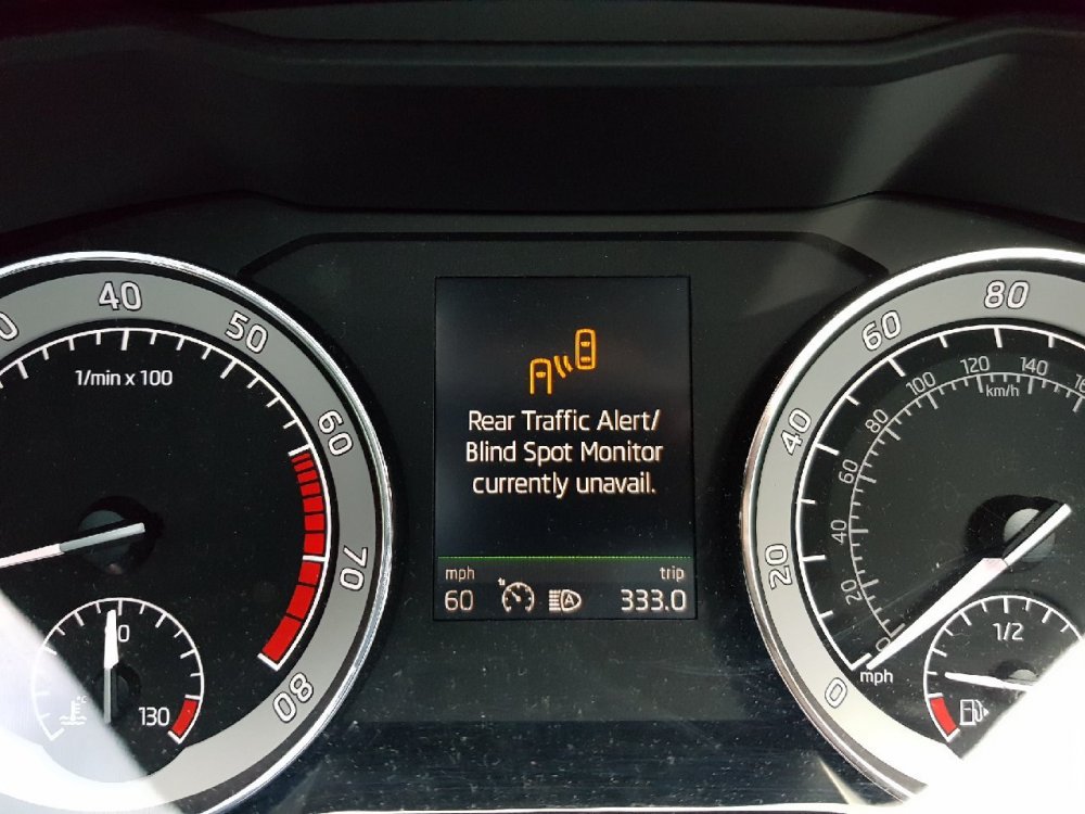

A slightly odd error on my Superb of the last few days...

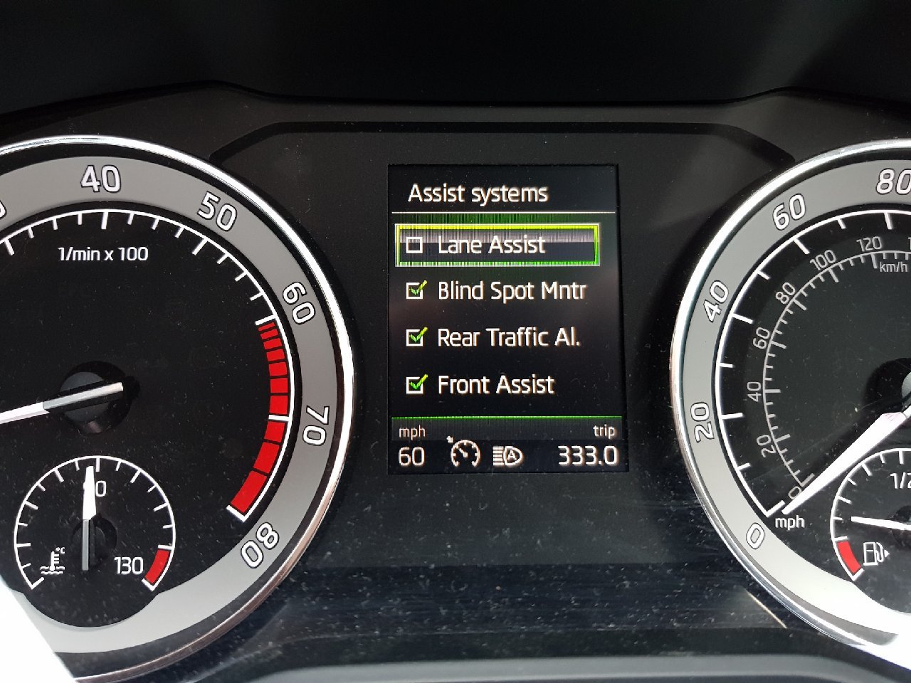

With Blind Spot Mntr & Rear Traffic Al. ticked as below:-
When I turn on the parking sensors (or they turn on automatically by engaging reverse or pulling up close to another object!) the following error flashes up briefly accompanied by a 'bong'
And the Blind Spot Mntr and Rear Traffic Al. are both turned off.
Any ideas guys & girls???

A bit late to the party on this, but I had the same issue.  After 2.5 years of everything working as expected, the error occurred as I was driving along and I eventually noticed that Blind Spot Monitor and Rear Traffic Alert systems were disabled.  Enabling them would work for some period of time, but then the error would happen again and they would remain disabled.  After some playing around I found that I could reliably get the sensors to fail by simply putting the car into reverse.
