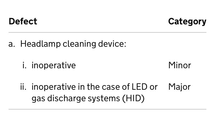

i was going give them I call tomorrow because this would fail mot
Don't believe a headlamp washer not working is a fail, nevertheless, the dealer should correct any faults or at least make you aware of them before you part with your cash.
Is a fail for sure.
34 minutes ago, Tech1e said:
Is a fail for sure.
It's a fail on a car fitted with xenon headlights, it used to be a advisory on a car with standard halogen as far as I know it still is.
Correct, thanks for the clarification.
