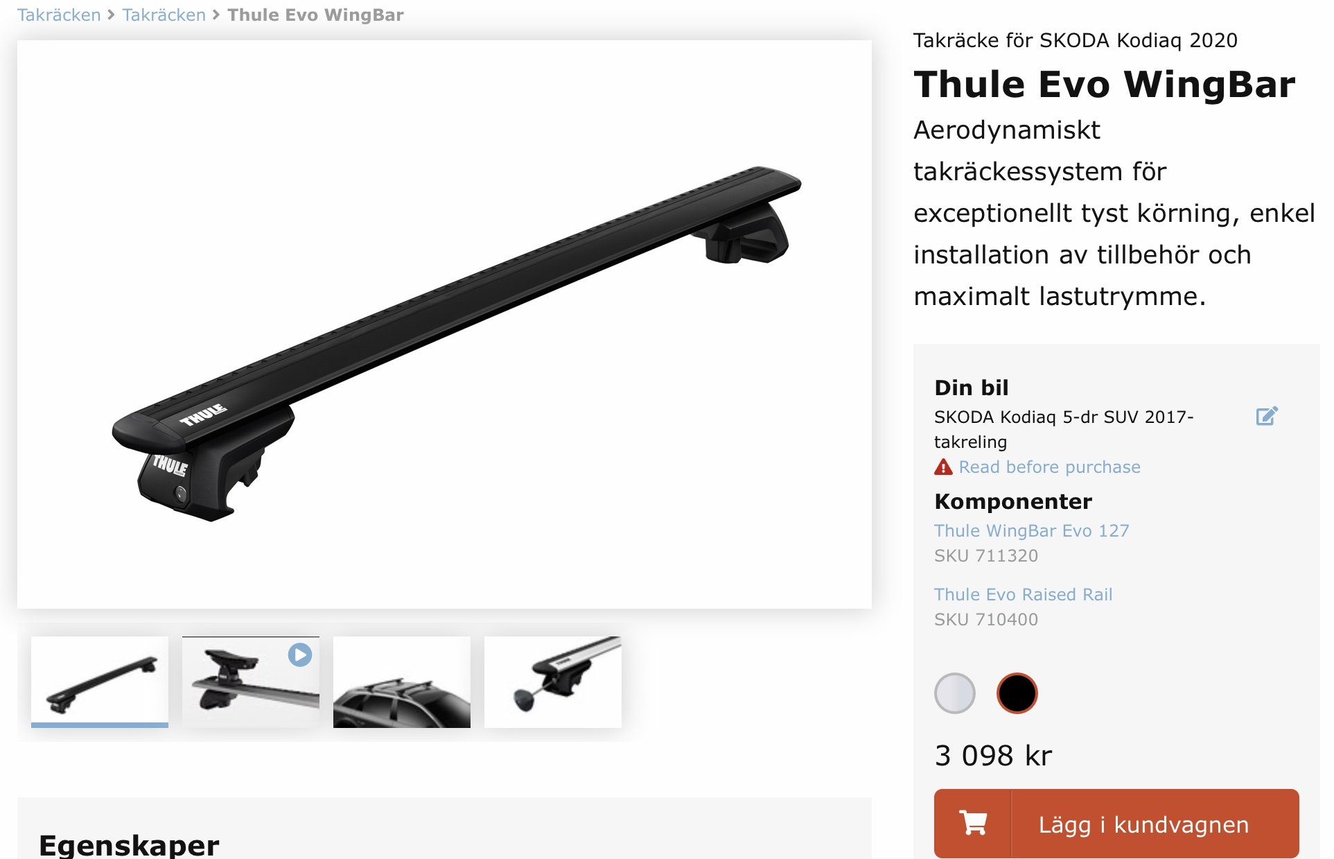

Thule website now has the same footpack recommended for Superb II and Kodiaq, model SKU 710400, so I would take that as the feet you have will fit.  Bars though are quite a bit wider, so you will have to change them, as not sure you would get the front bar to fit.

It looks like you’ve got the 118 cm wide wingbars. The Thule website recommended me the 127 cm wide wingbar before. Looking at your pictures, the 118 cm looks like the right size.
I'm not sure where Thule measure from but as you can see in my pictures mine measure 122cm end-to-end, strangely inbetween 118cm and 127cm?
-2 cm per end cap = 118 cm.
