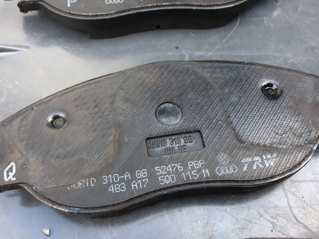

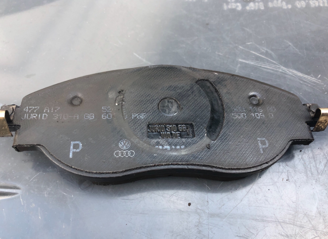

My SKODA e5 Octavia vRS 2015 (challenge) is in need of front brake pad change and I am trying to use some after market solution as I am not particularly happy about the OEM brake pads (maybe brembo).
Problem: after checking multiply sources I totally failed to much a correct brake pads, I can find OEM part number even that I have photos of the brake pads (below). Some of the consultants from multipul online stores had tryied to help me but what they had provided really is not reassuring as non of the number much.
Maybe one of club meber can help me to estblish the exact OEM part number for set of front brake pads for me car VIN: TMBAE9NE1F0123099

OE pads above are Jurid 310-A GG <this is the friction material rating - HH is better.
Is the 483 A17 5Q0 115M not the OEM part number?

The numbers printed on the individual pads may not lead you easily to the VW group part number for a set of pads, which is what you really need.
OEMwolf is a handy site as it not only tells you about superseded part numbers, but also gives you the subcomponents' part numbers for kit parts like a set of brake pads.
This page is a match to the info printed on your pads, I think, scroll down the page to the listing of the five subcomponents, and at least two of them, in abbreviated form, are present on your pad pictures:
https://oemwolf.com/oem-parts/8v0698151c.html
So the part number you need for a pad set is 8V0 698 151C, I think.

THANK YOU FREEDOM and Scotty72 ! Exactly i had a big problem to identify what would b the set OEM number, after even further  digging on 7zap and catalog parts for GTI I found that the part number is 8V0 698 151 C. I was struggling because I was not sure what is the PR number (I am not very skillful in VAG group just came in from MB) and apparently it is PR-1LG (oh well you learn every day). Thank you so much!
