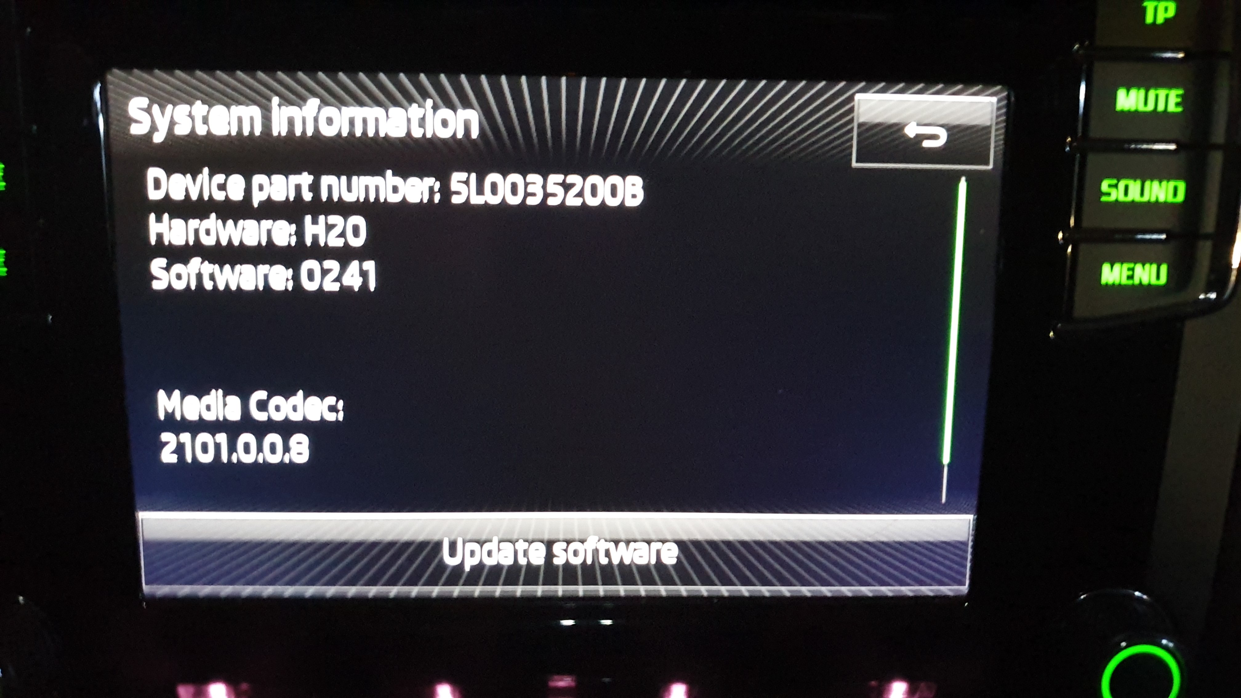

Pls post model number - can be checked in Setup / System Information menu.

No good?
Good, I was away for a bit. Your unit is MY16 Bolero non-DAB.
So you want DAB and SatNav unit? The best solution for you is 5L0035680C as it can be hacked with SW only. You must get unit, have it installed in your car and CP removed and then sent to me for hacking.
You can also get 5L0035680A - MY15  AMundsen, same procedure but it has MirrorLink only (no Android Auto, no Apple Carply). Or 5L0035680E (MY17 AMundsen) but it requires HW patch and CAN filter which make it more expensive.
