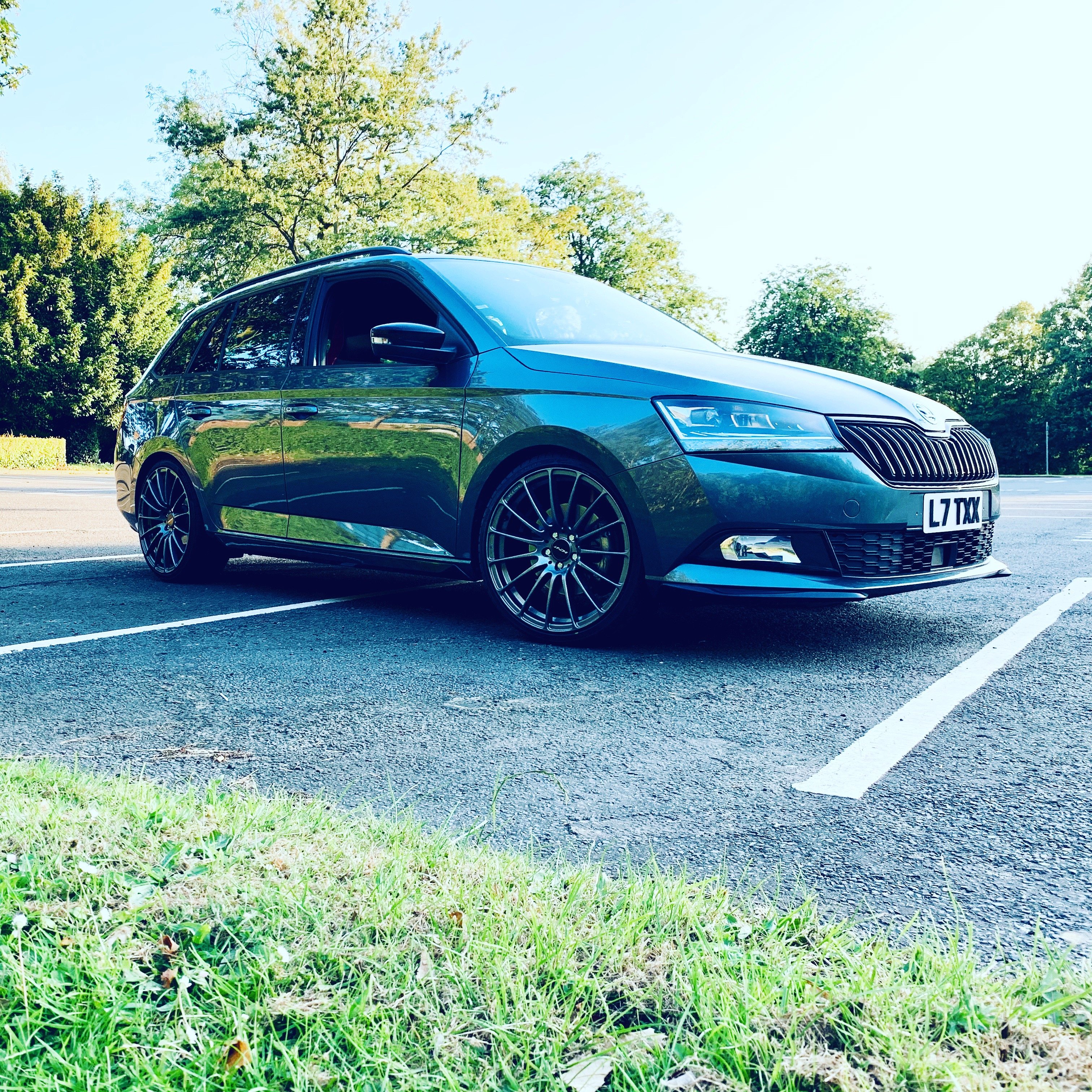

I’ve had my 110 mapped to apparently 145. Not that that figure holds any weight as it’s untested. I’ve put 10k miles on it with no issues. Wasn’t going to wait for apr... It a hell of a lot faster tho definitely recommend it. In the end needed suspension wheels and tyres to go along with it so it wasn’t so boat like lol

Looks very smart! Is yours a manual or DSG out of interest? I believe the gearboxes in the DSG are rated to 250NM rather than 200 so can handle the additional torque better (in theory).

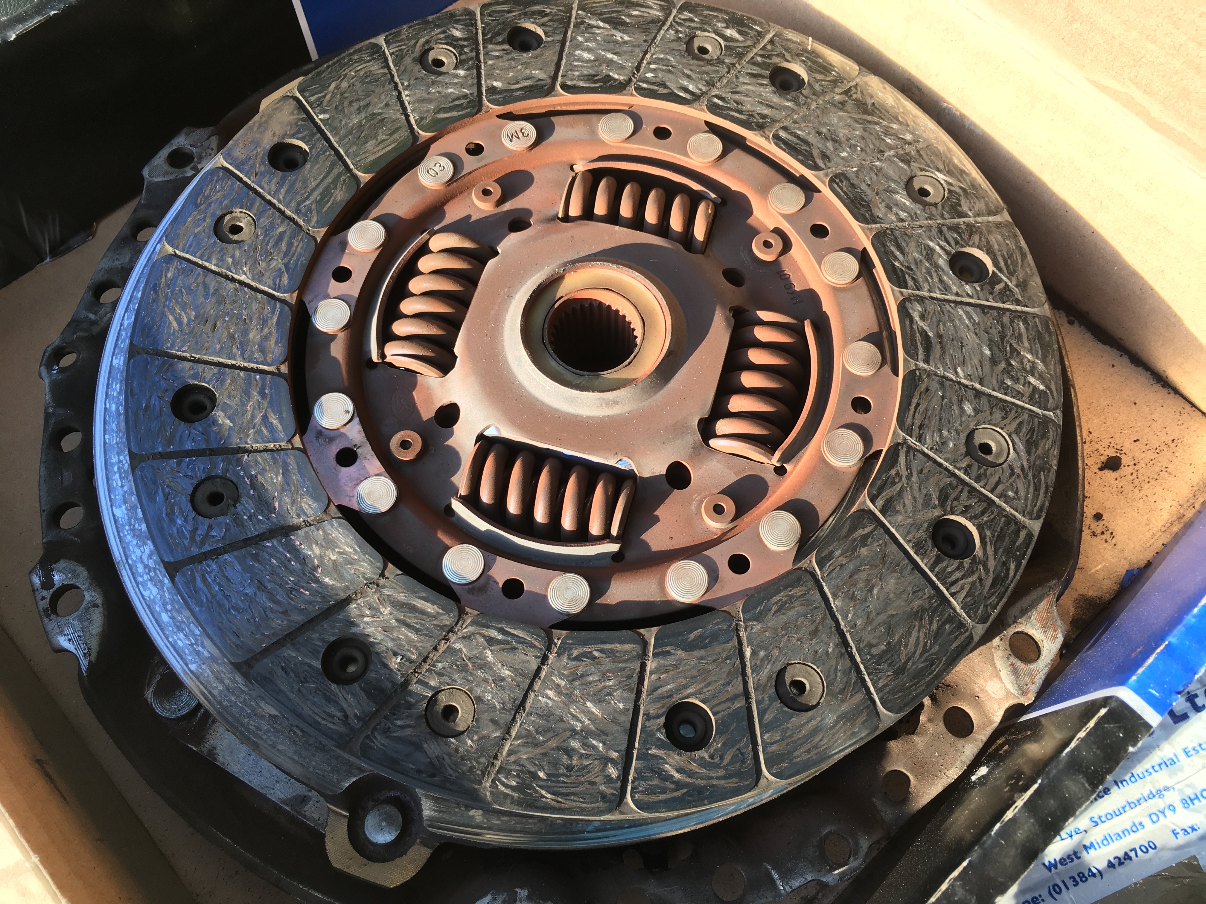

Mine got removed at 83k when the diff was fitted for a Sachs SRE and it was fine.

I never got to see mine but the pedal did nothing till right at the top where there was about 5mm of slipping and 5mm of fully engaged, it was hard to shift smoothly. The clutch degraded rapidly between 45-50k presumably from the heavy vibrations of the dying gearbox.
