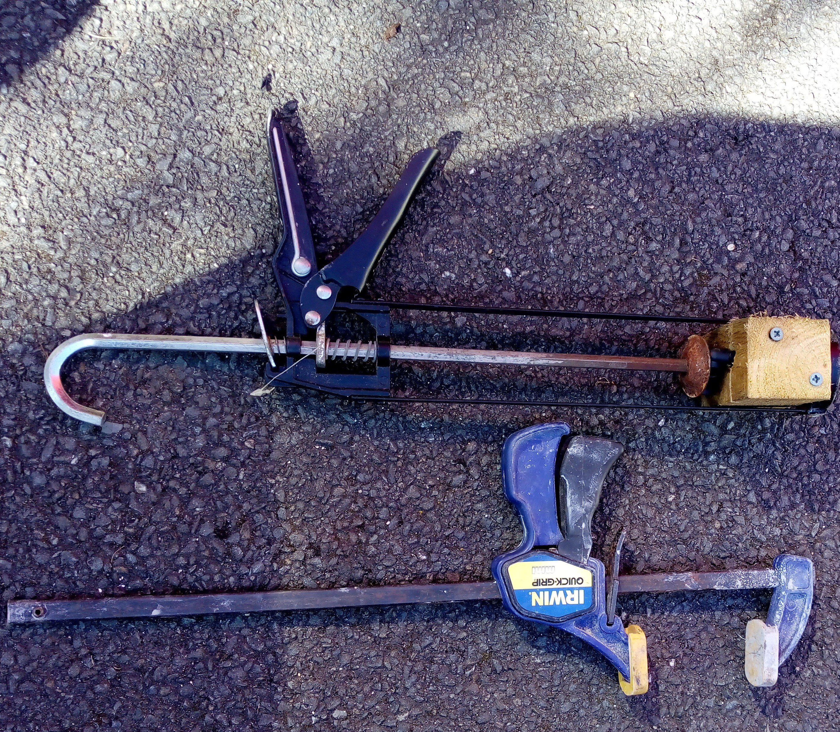

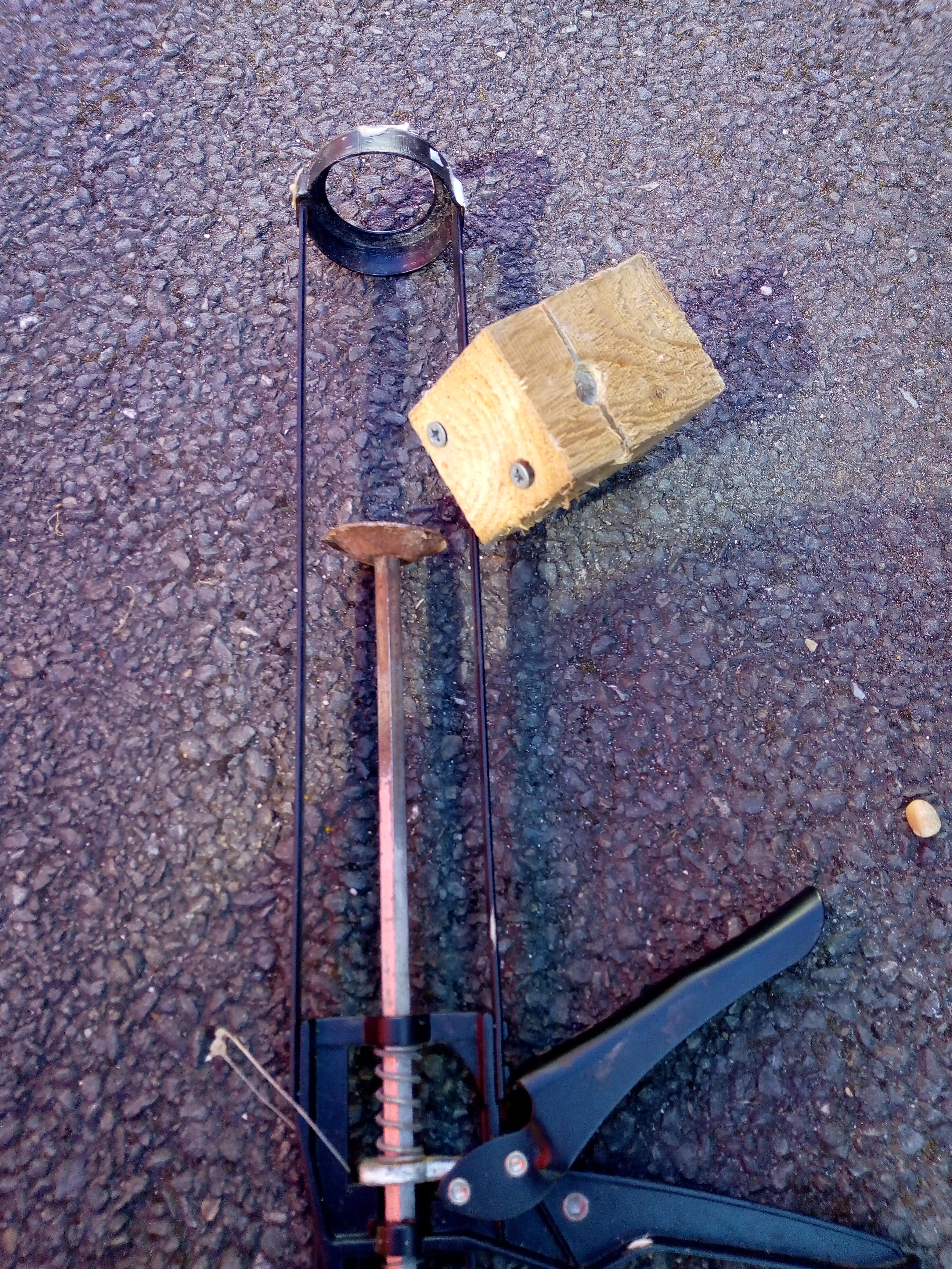

My line has inner diameter of 5.5mm.
I fitted the new connector to the existing line on the car using a block of wood with a hole in it, split in half and a caulk gun and grip clamp. The pictures do not show the fuel line but you have it in the middle of the block tight enough to hold onto it but not so hard to crush it.
I used a tiny dab of light grease and squeezed the connector in. No leaks on idling or reving the engine on driveway but time will tell if it is secure....

nice bodge though, hopefully it works!
I'm hoping it won't happen again with the new clip as it has a much more obvious and functioning release mechanism!
