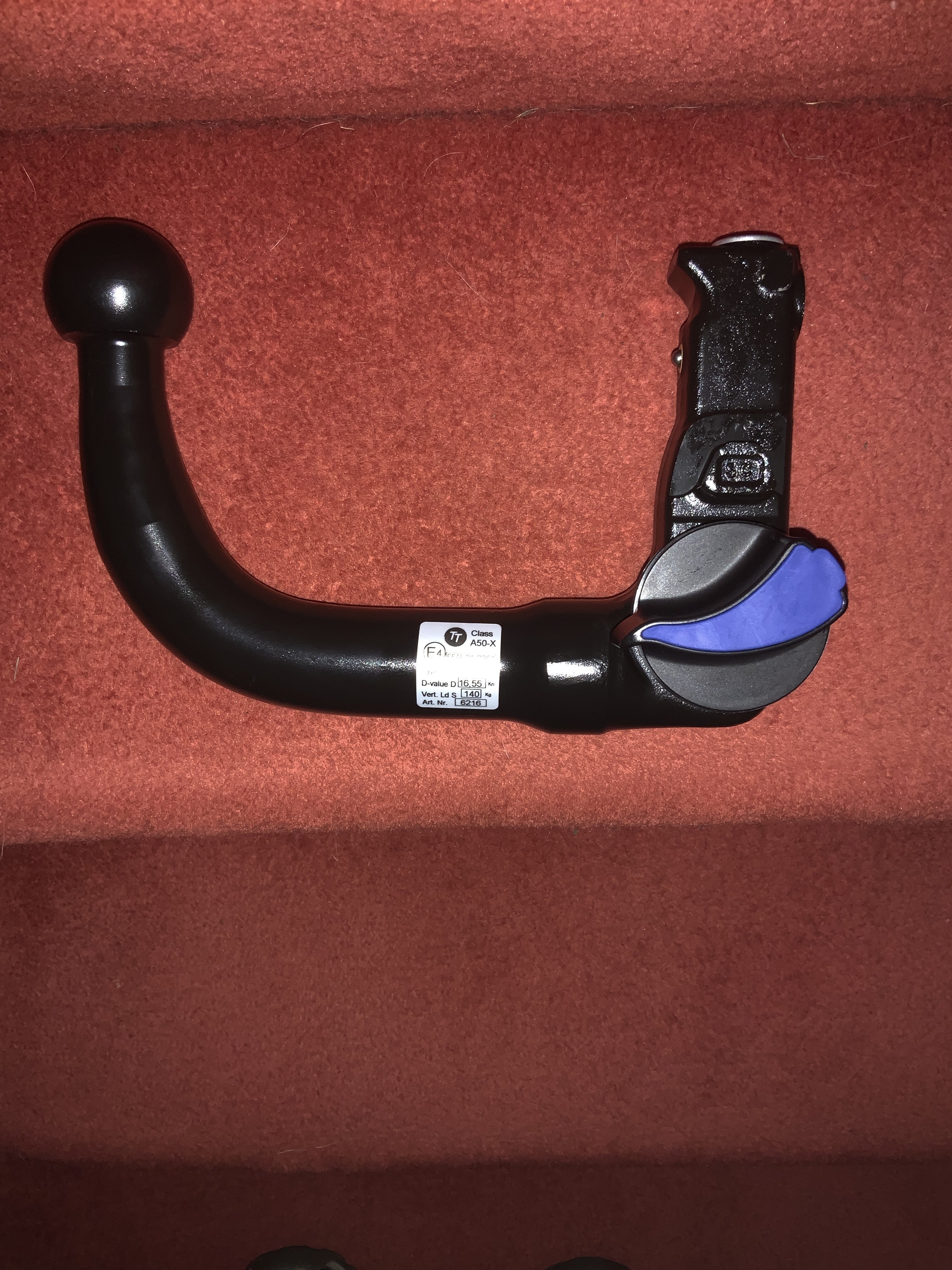

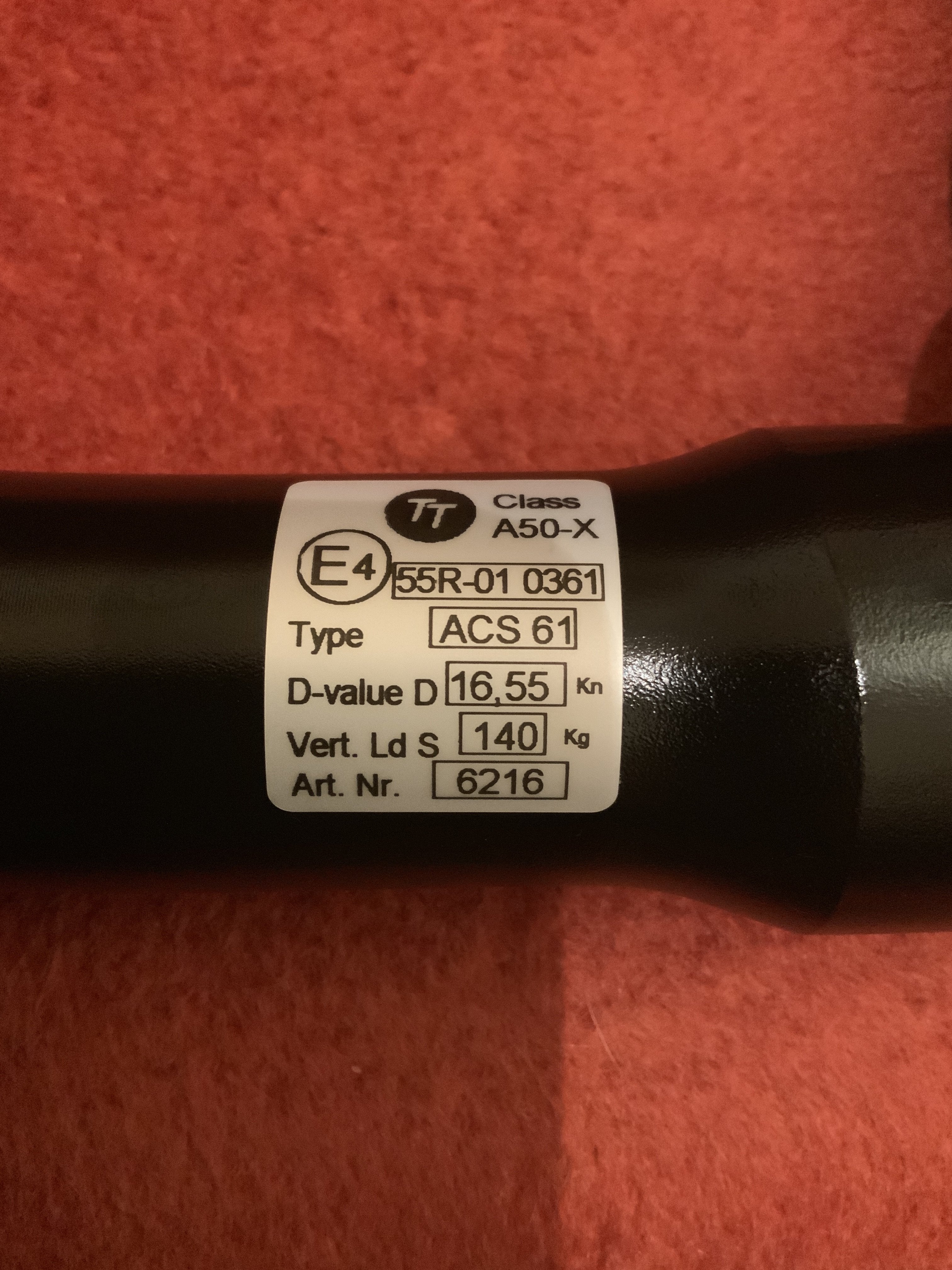

.. and so Buchans of Glasgow have fitted my car with a ‘Tow-Trust’ detachable tow bar. On checking the website it is rated at 100kg static load (20kg higher than the Witter equivalent), although the sticker (see photo) seems to say 140kg?. I hadn’t heard of Tow-Trust but they’re British made and Buchans seem to be fitting them as standard. All which is good news to me as my (5 seater) Kodiaq has a certified 100kg load capacity. Thanks to everyone who contributed. I’m happy I have both car and towbar with 100kg rating. All that remains is to test it out at the September holiday weekend. Cheers, Andrew.
