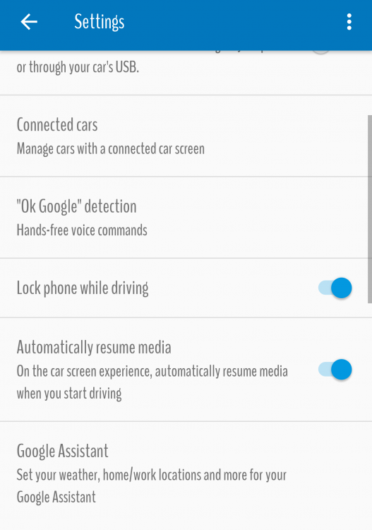

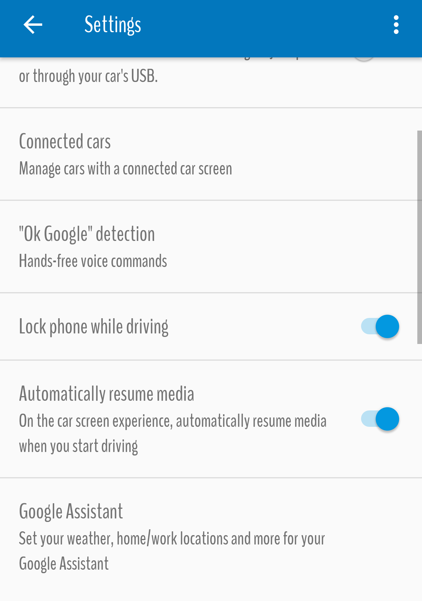

For no obvious reason, a paused Podcast on my phone connected via Android Auto will apparently randomly resume and take over from radio or media.
There is a setting in AA to automatically play, hence take over, music.
Turn "automatically resume media" off.
Interesting thought, JR RS. Thanks. I'll try that and see how it goes. Naively, I assumed that "automatically resume" means that it does so only when you haven't used any other entertainment source meanwhile. The Podcast just randomly butting in seems outside of that. But I'm probably not allowing for the clash of understanding that occurs between the respective software development teams at (german speaking) VAG and (american speaking) Google. It's this kind of thing that makes me reluctant to be a beta-tester on an autonomous vehicle 😁.
