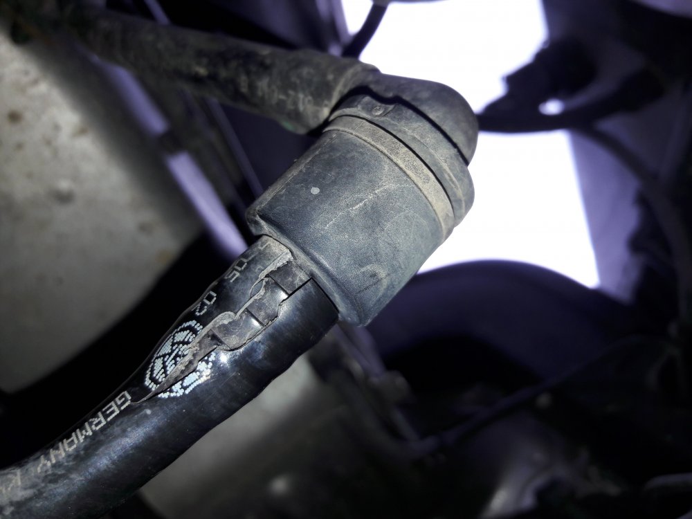

Thank you for information Wino. Where can i find a some pictures about that hose?
Look for cracks in the plastic pipe at the connections like this....
20190317-131655-thumb-jpg-a7ee33141f6c8b
20180719-153158-thumb-jpg-80292583784699
