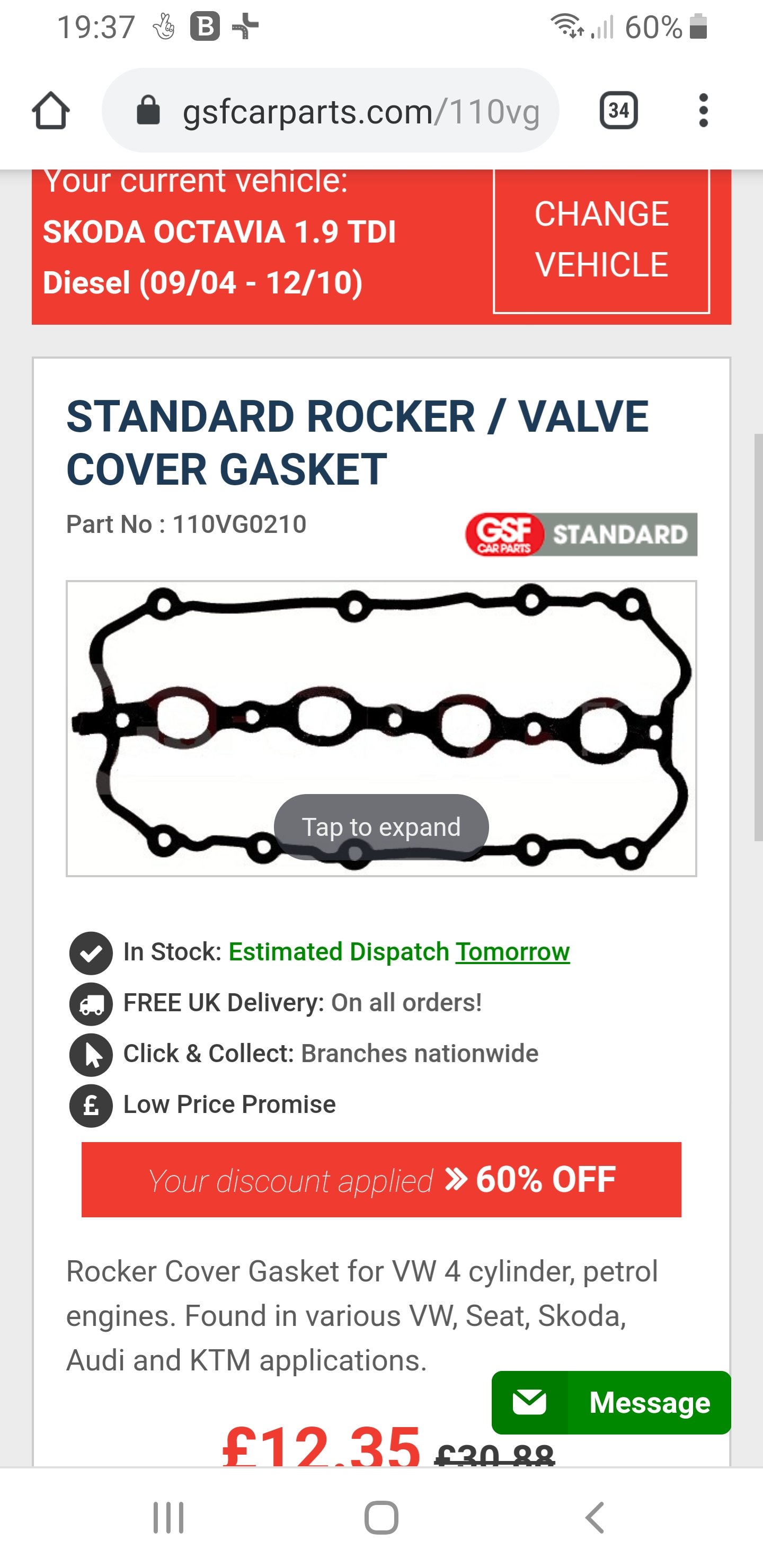

Ordered the gasket from a well known auto discount store this morning 1&1/2 hours later it turned up guess what WRONG 1 another 1 came wrong 1 and another 1 came and guess what WRONG 1 again so all 3 turned up and all wrong brilliant so tomorrow am going over with my gasket to get the right 1 hopefully.
They all had the right part numbers on but the gasket inside was wrong so here's for tomorrow.
Why don't you get from direct from Skoda?
A gasket won't be that expensive, and it's probably better to get something so important from Skoda if your supplier have messed up so many times.
I've never had a problem with GSF

Because when a ordered it was for delivery my local TPS or main dealer won't deliver if no luck tomorrow a will be going to TPS.

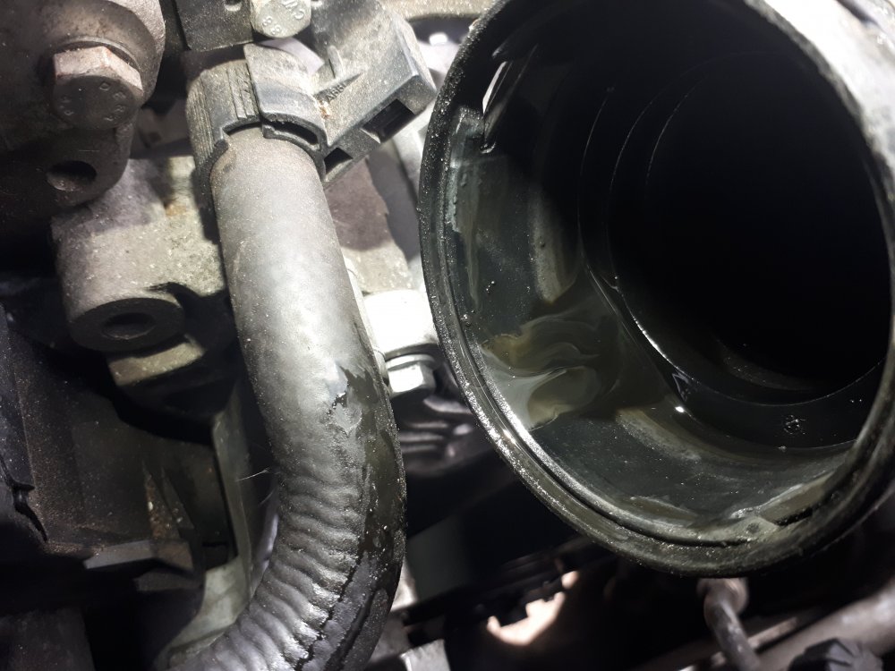

A tell you what a did notice when a was mucking on with this little issue a don't no what you's think.
This was from the intercooler pipe.
