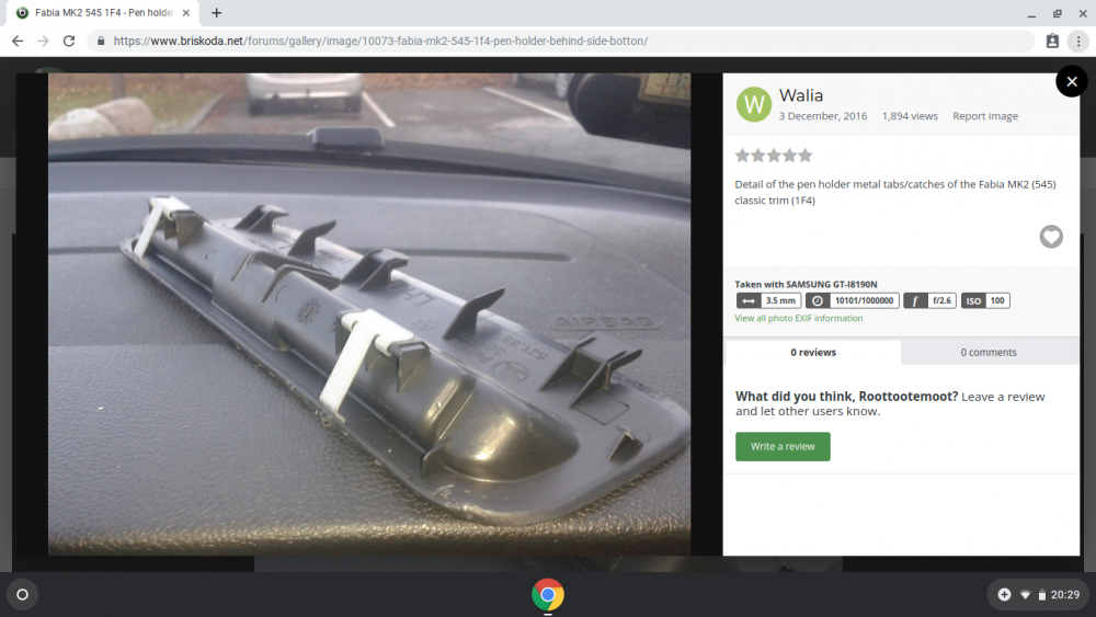

@Walia
Cheers, every day is a school day.
Edited by Roottootemoot
