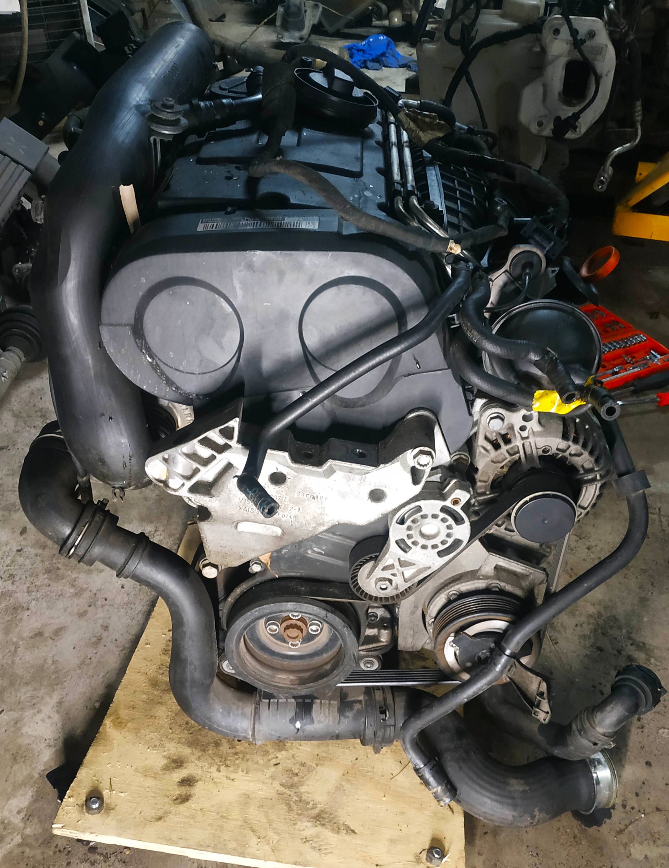

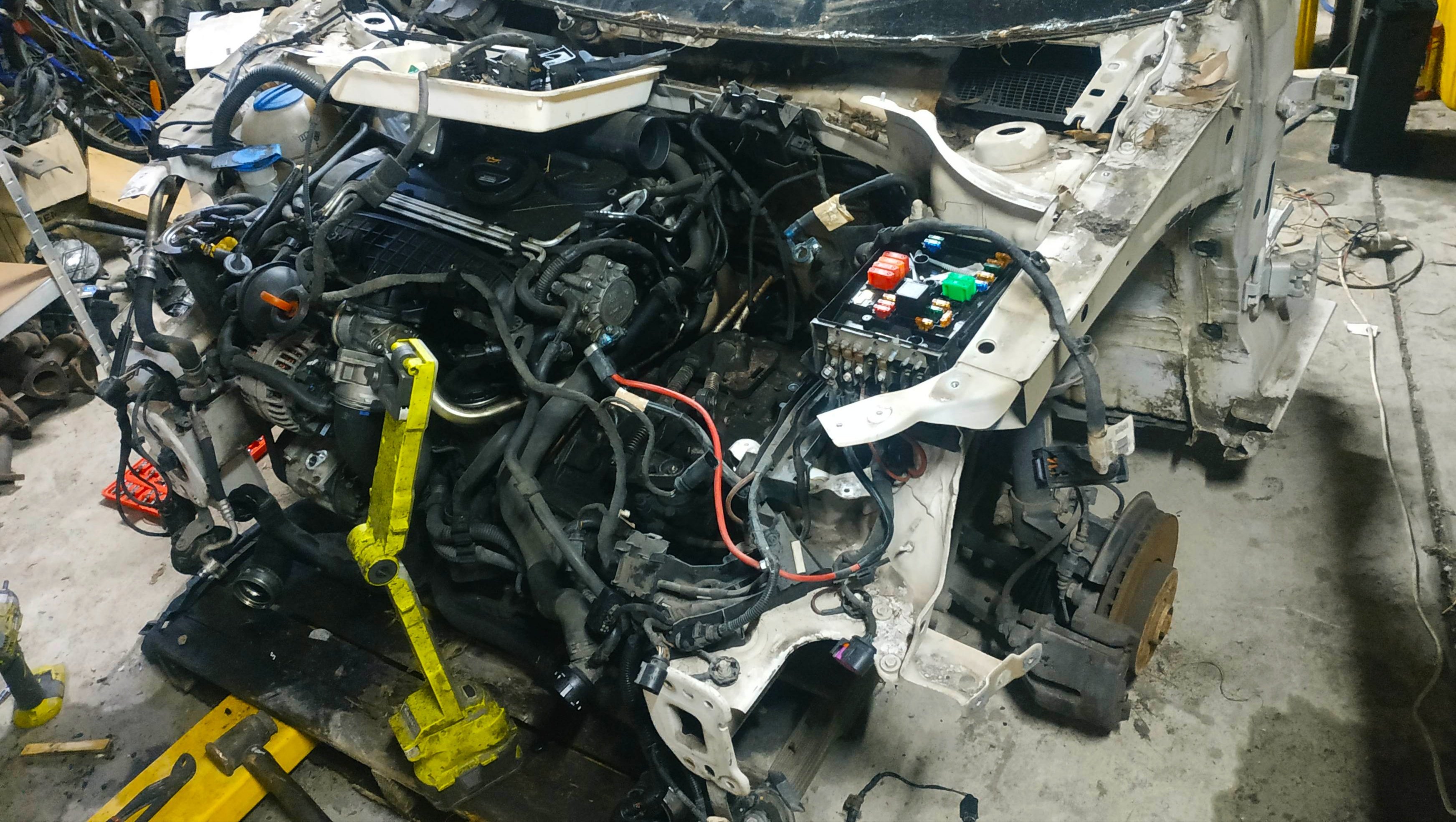

I have a complete BKD engine (16v 2007 VW Golf front cut) with,  ecu , engine wiring and interior wiring etc . I'm considering converting from BMM to the BKD. Yes i know its a lot of work (theres a lot about the BMM i hate too) , but i do cherish my 4x4 wagon and plan to keep it for many more years so to me an engine swap is viable at little cost other than my own time and probably getting the immobiliser in the ecu off so i can keep the existing display etc.
Sooooo ! I'm looking for a wiring diagram for both a 2008 BMM skoda Octavia and an 2007 BKD VW Golf , i know the engine harness will swap right over but there is one major difference in the ecu too interior loom (its the vacuum module on bulkhead) and i'm hoping the difference is confined to the engine compartment and runs just to the ecu and can be spliced in or repinned so i dont have to pull the dash out :P

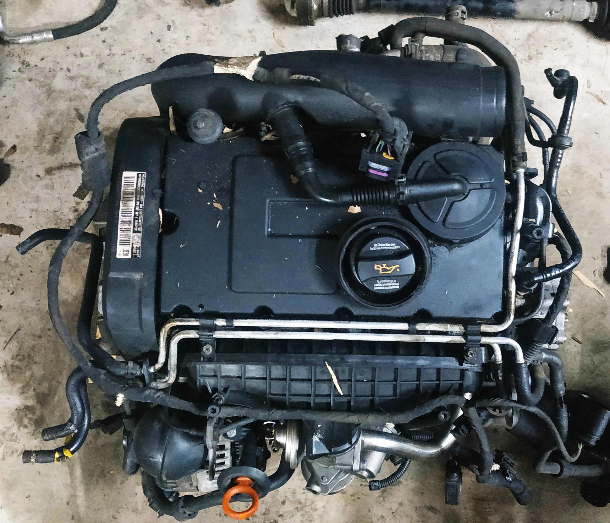

The BKD is 16v TDi and the BMM is 8v TDi, the head is def much wider, plus has the 2 cam pulleys .
I just posted looking for wiring diagrams for both BMM and BKD, but there is a BKD photo in the golf front cut (now removed and gearbox off as of today)
