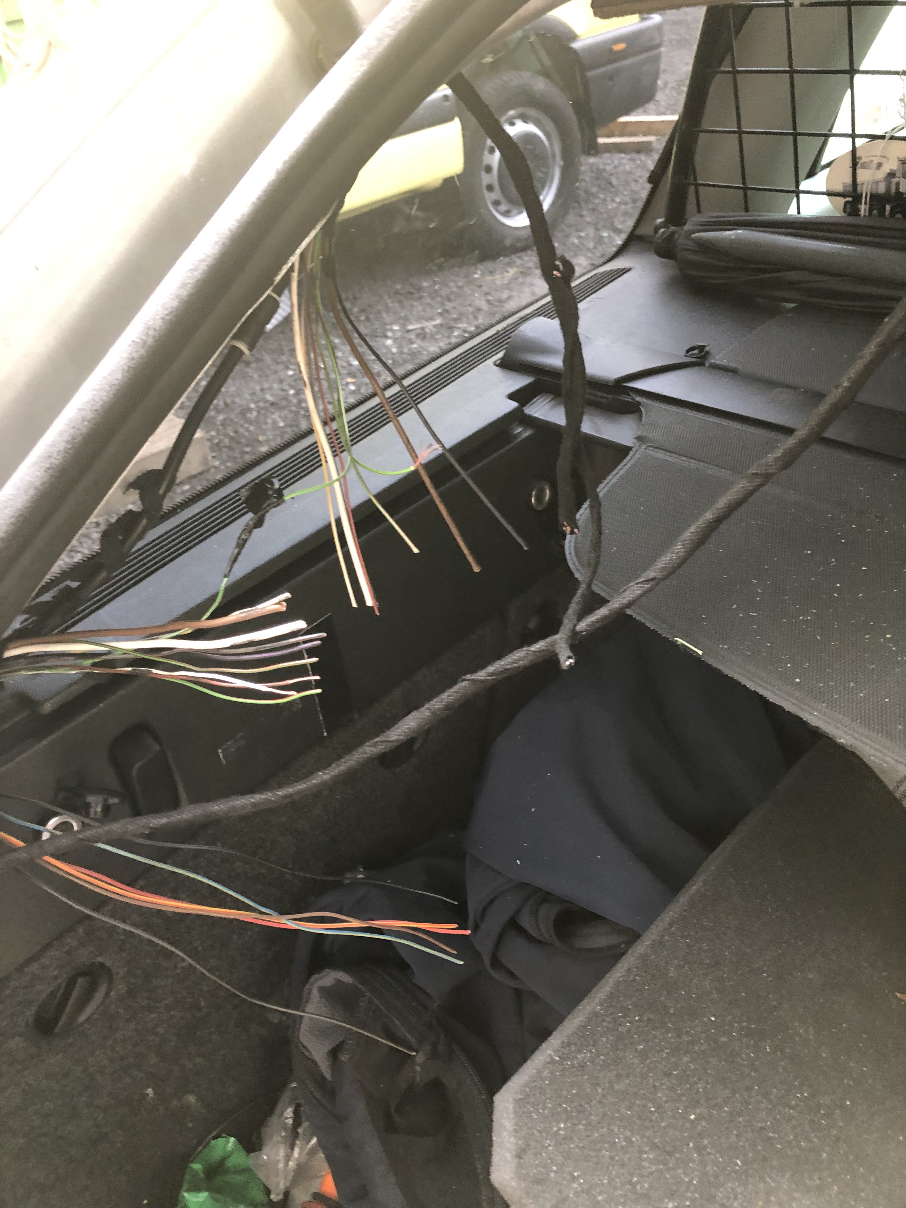

Hi guys,

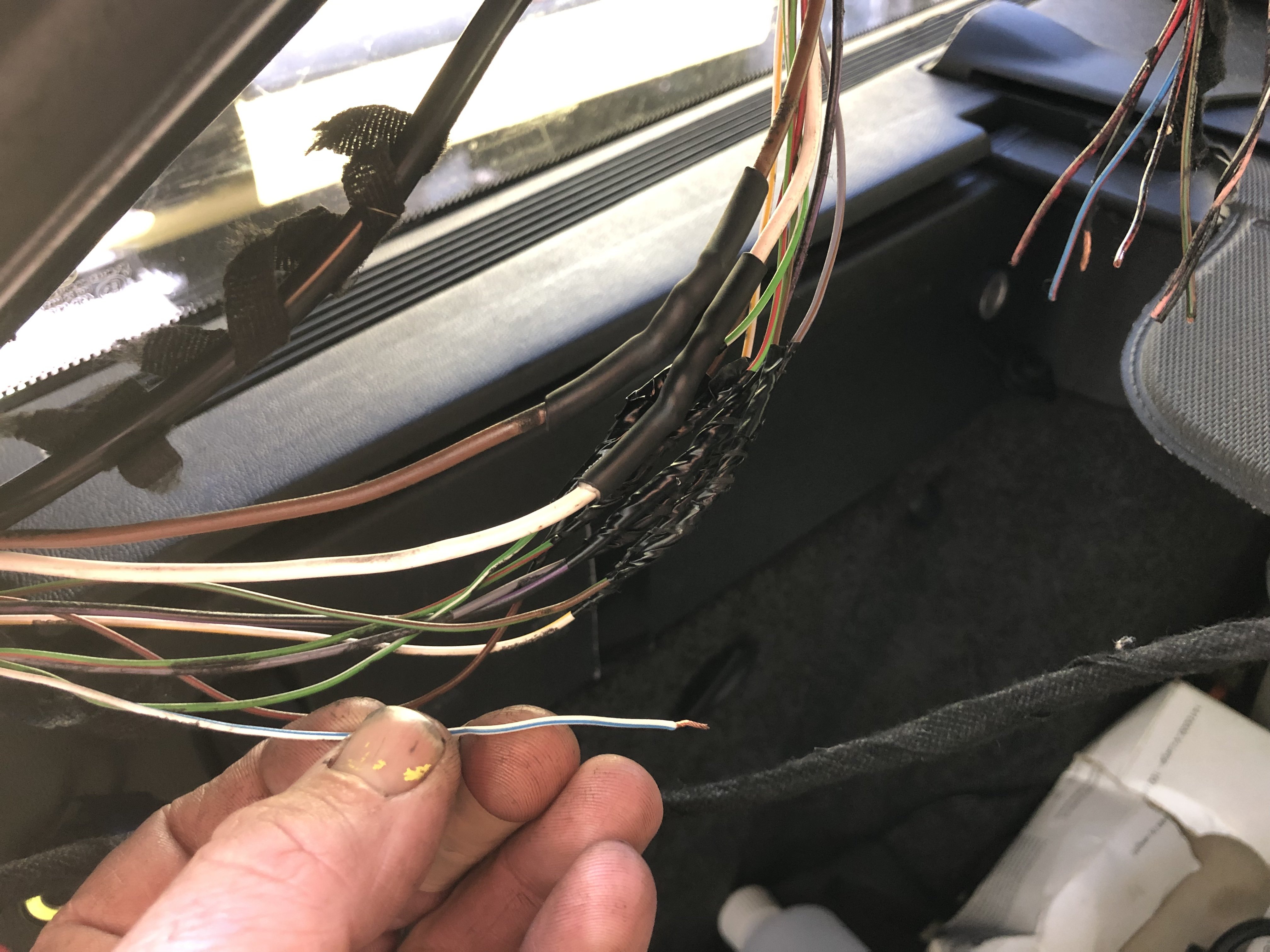

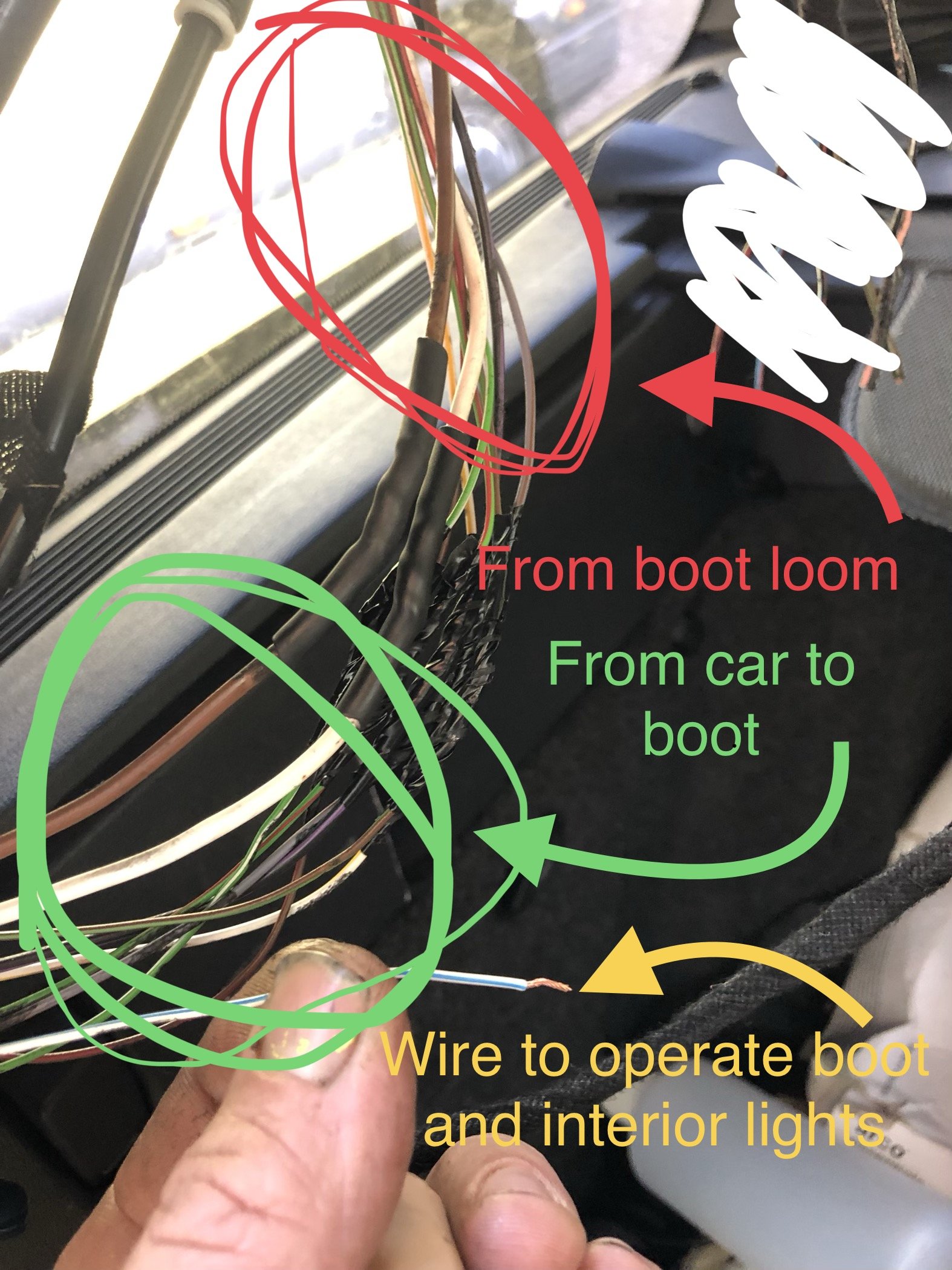

 I’ve changed the boot on my 2010 FL scout for a cleaner one same colour etc but from a 2013 FL model. All the wiring matched up colour for colour etc but there’s one wire on the original loom (white with a blue trace) but NO wire on the new boot loom to connect too, this is causing the boot lights and interior lights NOT too come on when I open the boot... the dash shows the boot is open etc etc, does anyone no where the interior light feed connects to so I can just solder it back where it should be. Photo below.
 Many thanks
Forgot to add...
 other wiring in photo is from and for the blue lights etc etc as it used to be an RRV paramedic Responce car. (My own)
