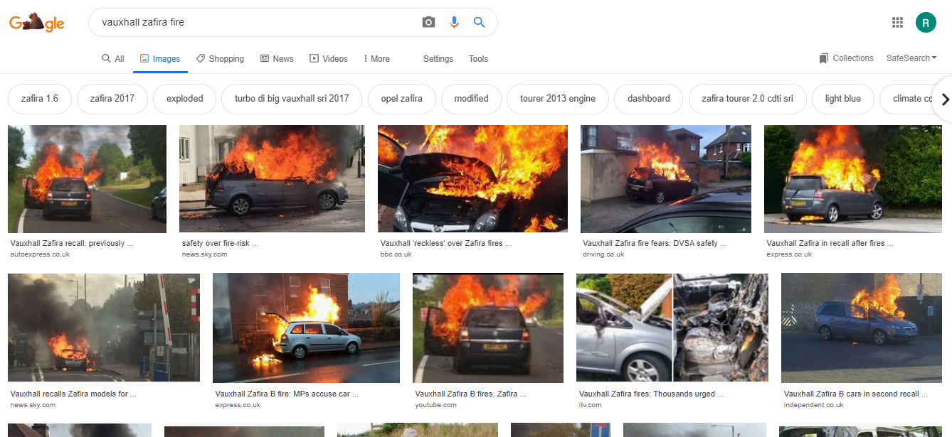

This would be making me really nervous, there have been some very high profile cases recently in the media with Vauxhall (Opel) and their Zafira, as well as BMW and their 3-Series with several cases of cars setting on fire.
Not sure I would be able to trust my car again if it had the same issues as yours.
