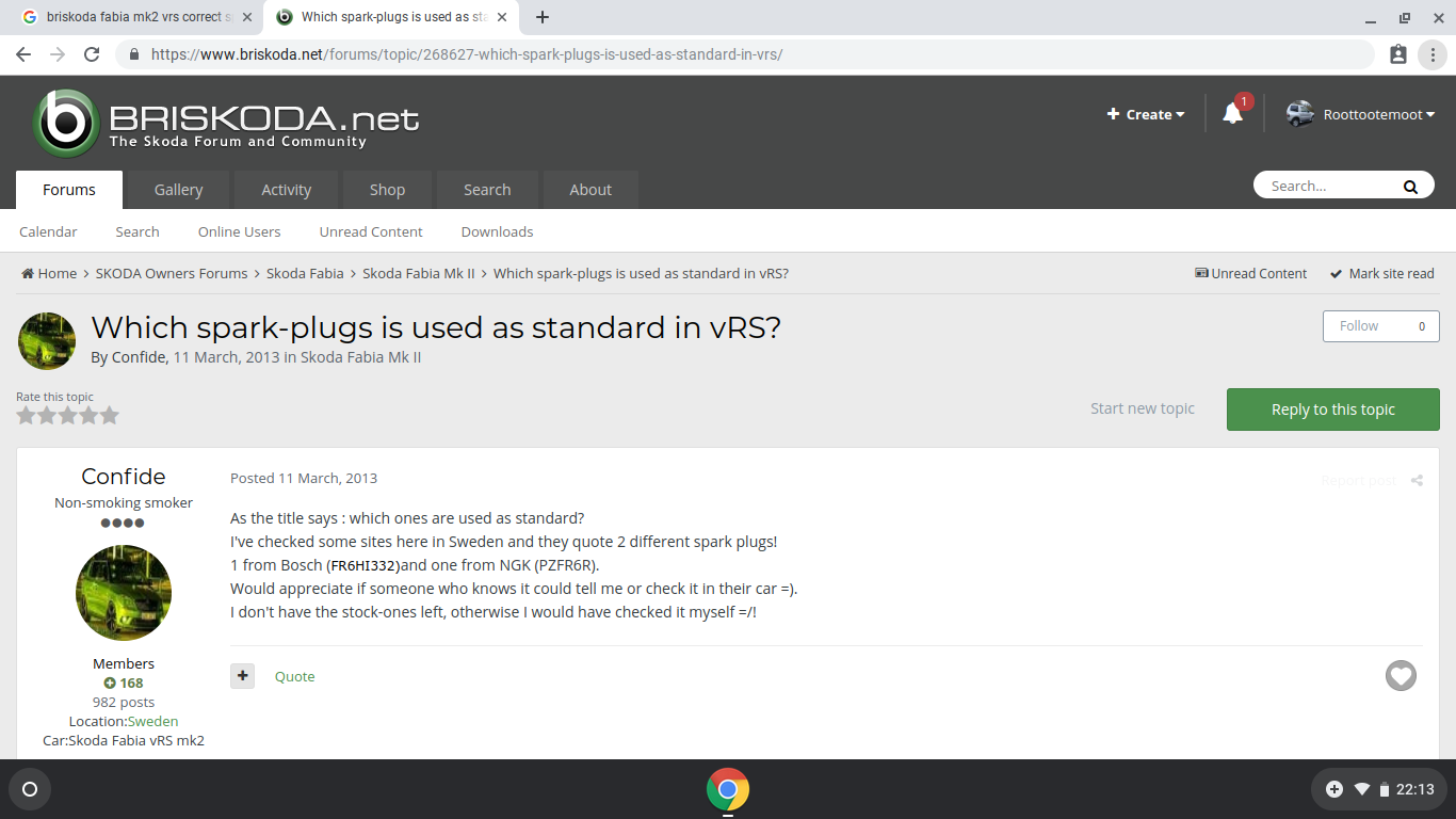

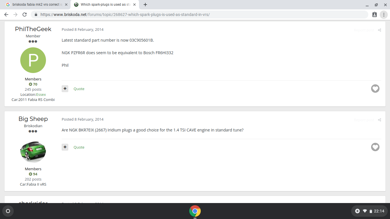

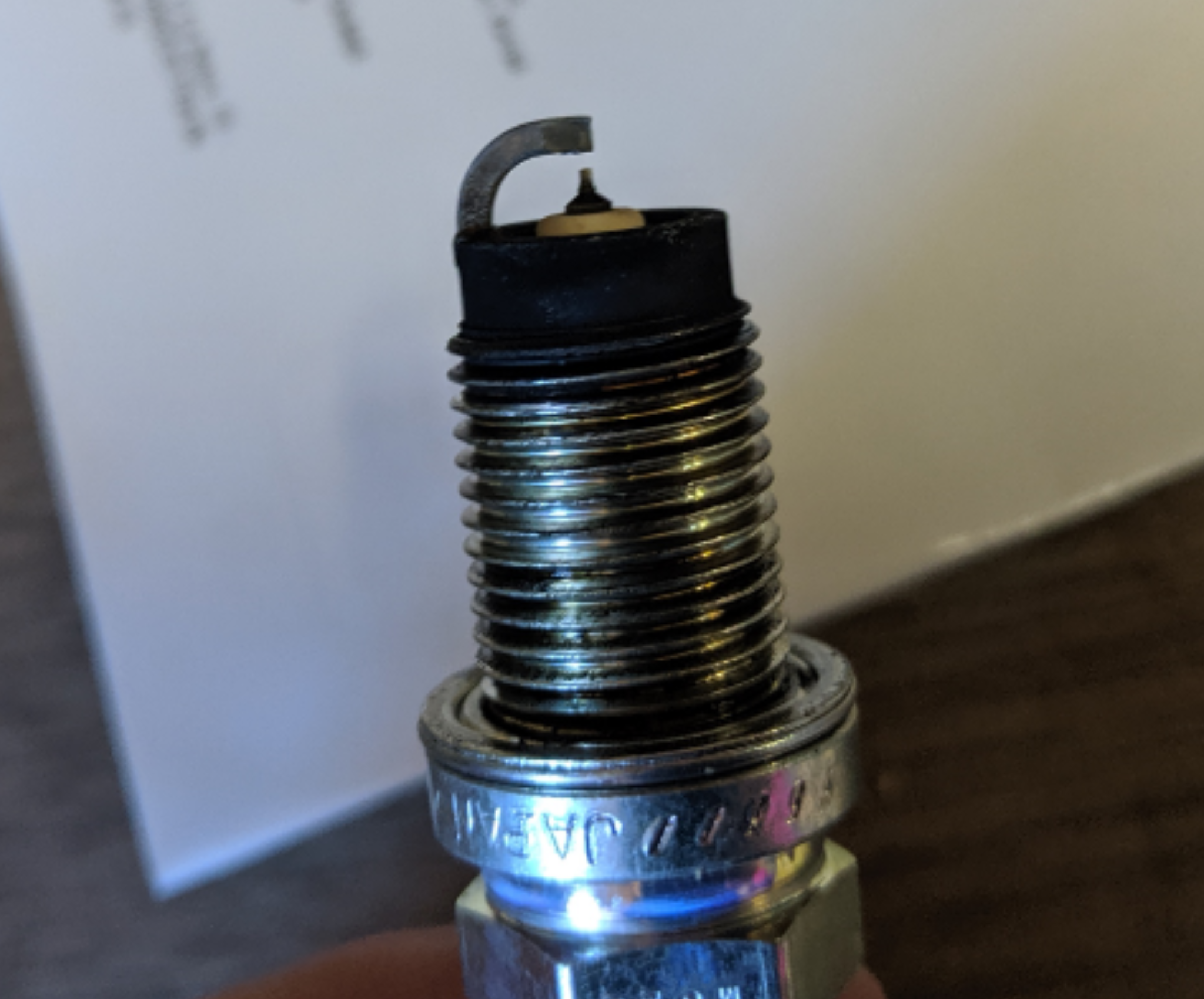

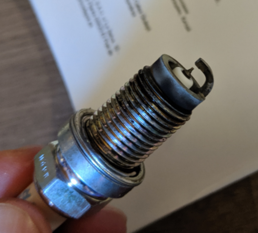

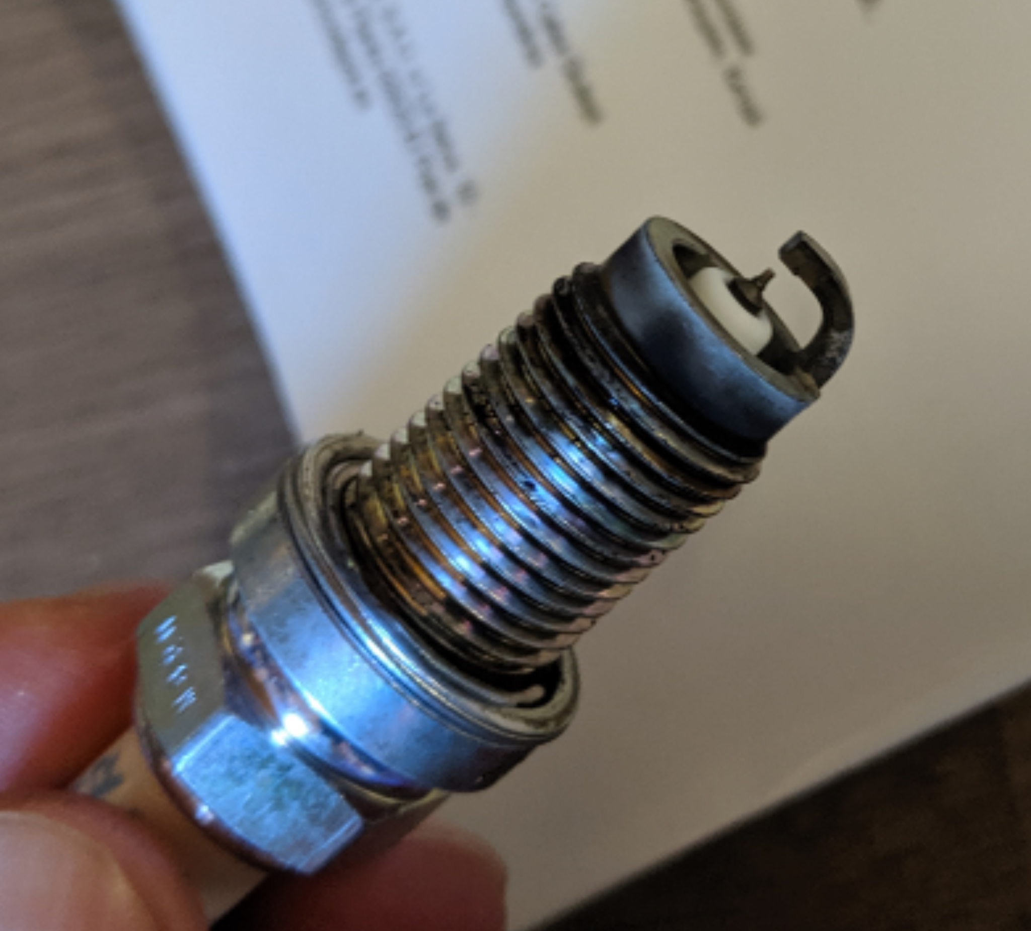

So I pulled the plugs and 3 of them were like the first picture and one had slightly different deposits as seen in the 2nd picture.
They are NGK sizfr6b8eg and were gapped at 0.7-0.8mm.
To be honest, I was hoping to see at least one of them in a state. They do look like they are only a couple of 1000 miles old.
Edited by Smogzilla
Double picture
I would still put in new plugs, and the DENSO.   First clean those and have them at 0.7mm
If issues are continuing and it is misfires then best have the timing chain measured.
Assuming that the Ignition Coils are OK, the Intake and sealing is ok, no punctured breather from the last plug change.
Last OEM Plugs i removed from a CTHE were.
NGK PZFR6B8FG & 0.7mm gap.   (NGK 96498)
So you have SIZFR6B8EG  (NGK 96209)

@Smogzilla - This may be your photography, but those plugs all look sooty to me.
