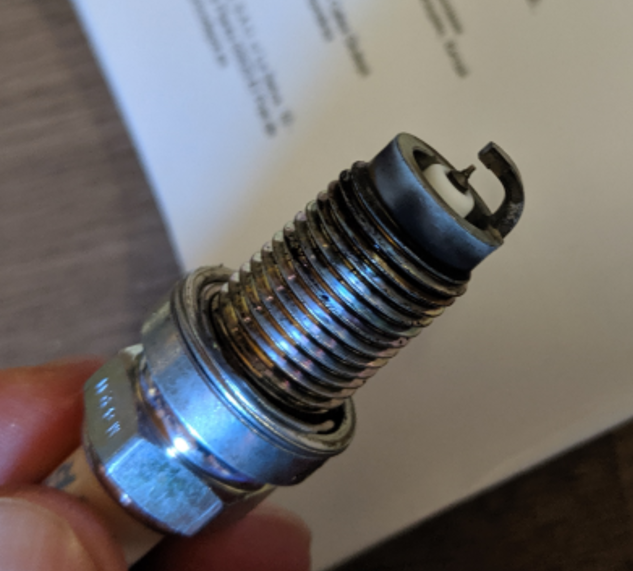

Odd, blinking engine warning light on my Fabia 2 vrs
They do look like it is running rich.
Usually it is one plug that has soot, gets oiled, fouled and then breaks / burns up.
But then it has had a software update and is misfiring, and not getting thrashed.
Usually before i remove plugs i take the car get it hot, thrash it and get the plugs cleaned, then remove when cool and see how they look.
If the car is not runnung right it is not safe to do that.

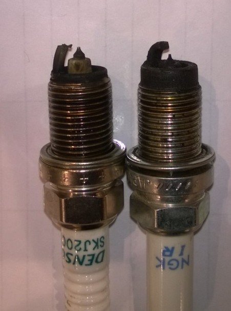

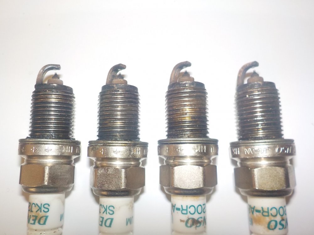

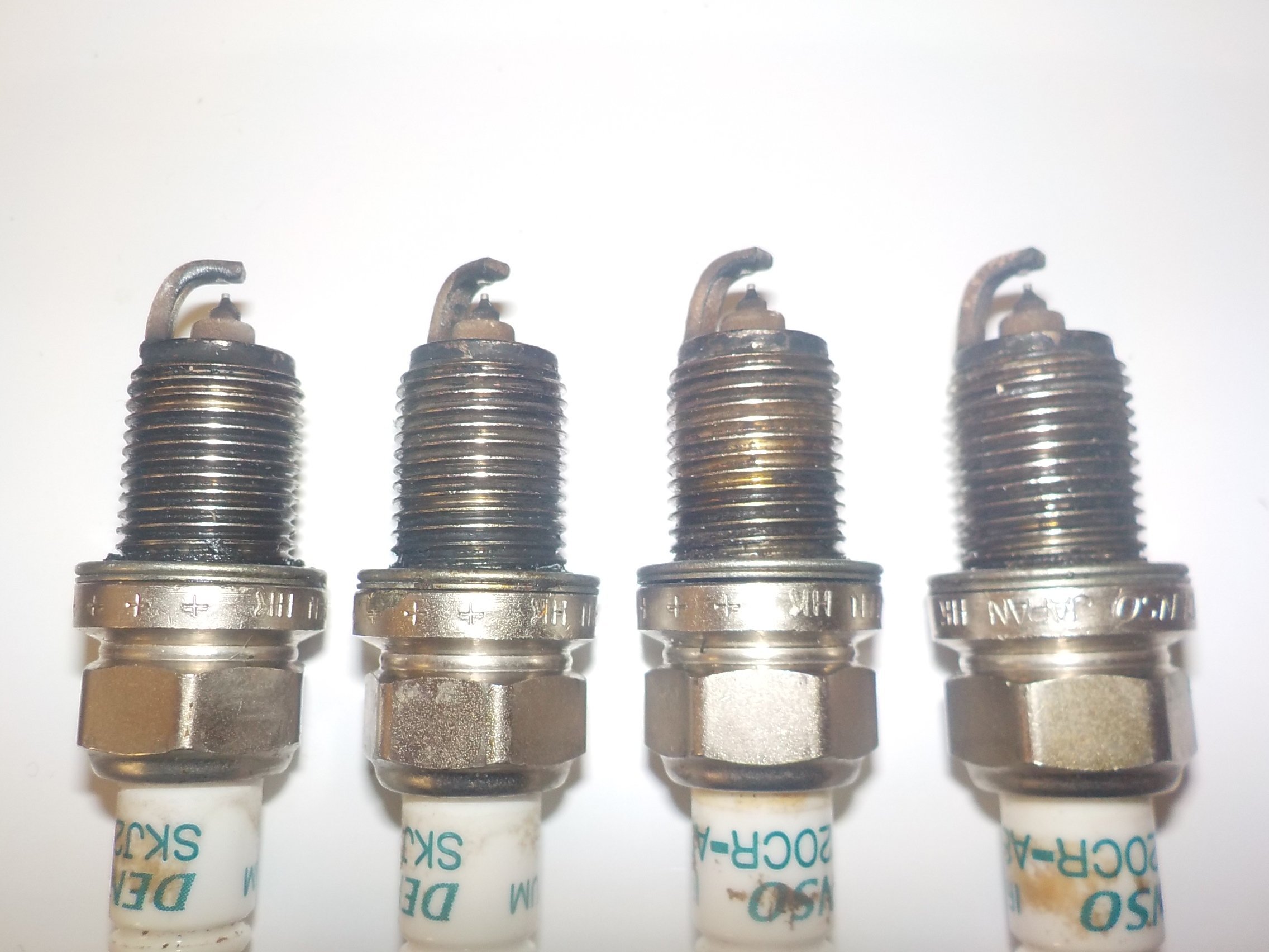

Just examples from threads in this section.
DSCN1971.JPG.24252dd4f3b17404166d0f610abfd623.JPG.3213a1d8fc10fa337898889acda5b4f4.jpeg
58e6752cc5cf0_DensoVNGK.jpg.f8fe49c9c1cd816bc44c4abb2bd41586.jpg.f54d2208425c568a50e54db1340eaf1b.jpg

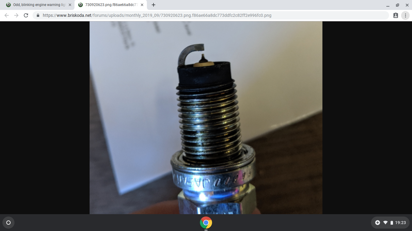

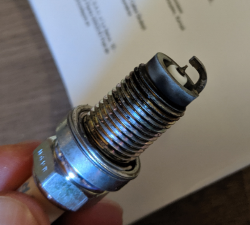

1 hour ago, KenONeill said:
@Smogzilla - This may be your photography, but those plugs all look sooty to me.
You are correct, Ken. They do look quite sooty. Well, 3 of them do anyway. The other one has the greyish brown deposits I'd hope to see on a healthy engine.
Jesus, some of those plugs are shocking.
Edited by Smogzilla

Forme only one of the plugs looked right, the other 3 were sooty. So does that indicate a fault on 3 cylinders? When I next go there I'm going to ask to see all the reports from the various tests they are performing to make sure they haven't done anything as daft as what you posted earlier.
