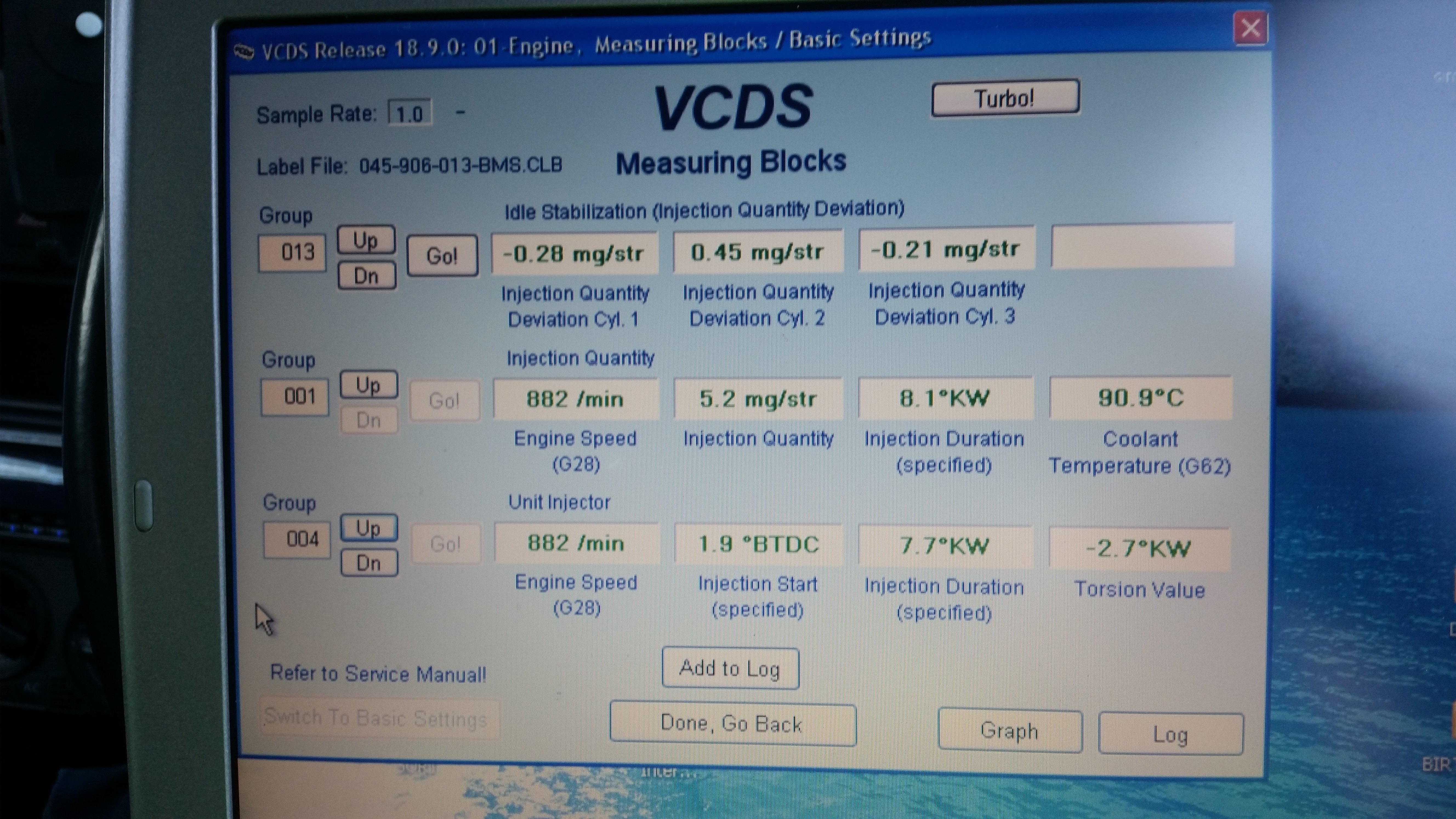

As i have said I'm new to vcds and i looked at the measuring blocks and noticed number 2 injector is a massive diffrence from the other ones.

Update your VCDS, it's quite a bit out of date.:thumbup:

Sorry forgot to mention this was done with the car not running and the ignition on.
