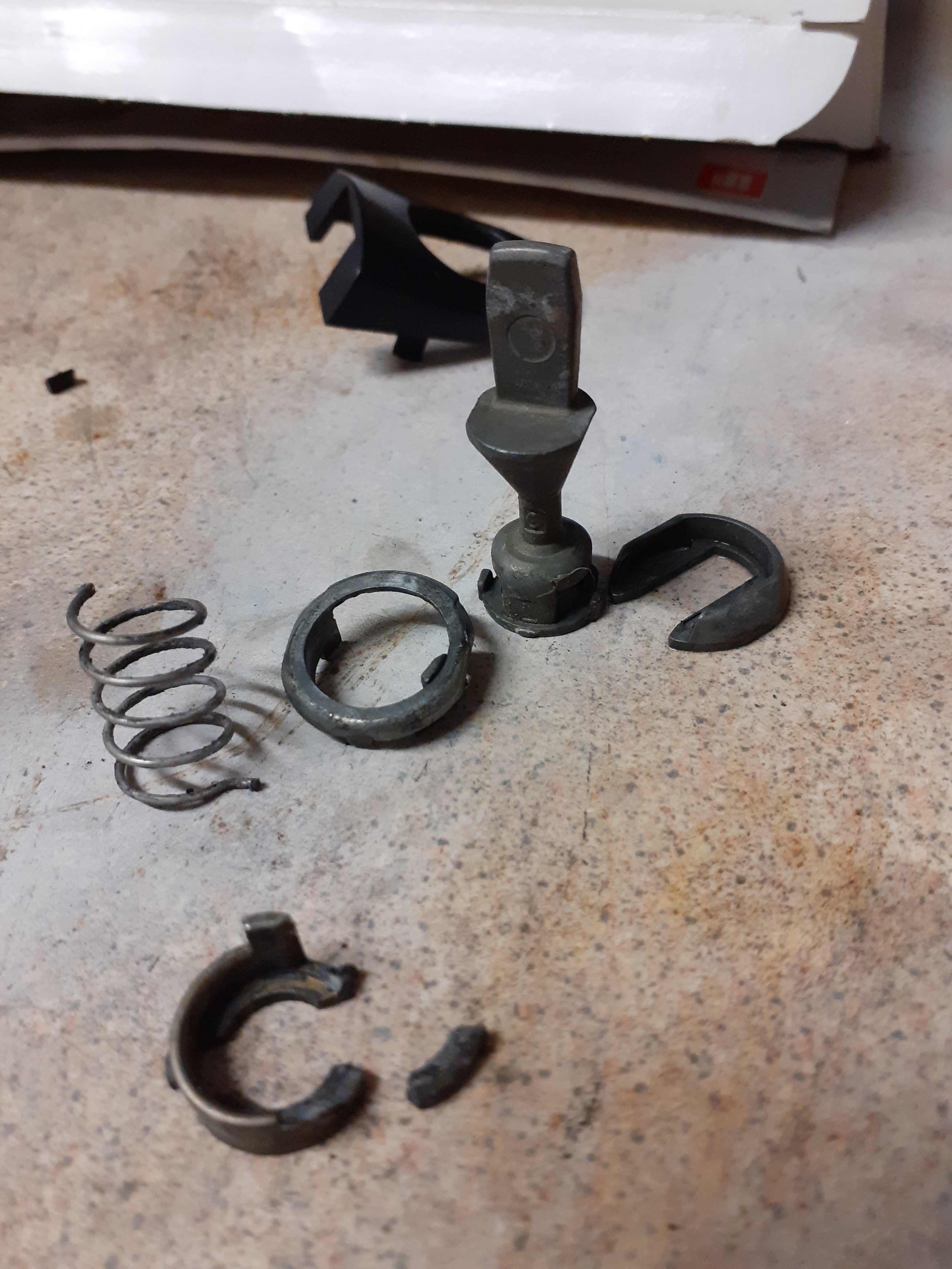

Sorted, sort of.
It is a T20 but my aim was not good enough. Two minutes and it was out but a few more minutes revealed this broken part which was presumably stopping the lock from working. Everything else seems fine.
Off to check if the repair kits include this part.

Just a word of warning! The little black screw holds the lock in place. The bigger gold one moves the retaining ring on the inside of the handle. When unscrewing the gold screw count 12 TURNS only and that will be enough. If you unscrew completely the retaining ring may fall into the bottom weld of the door and its a job to get it out. Removing the complete door handle assembly is then the best option unless you can wallpaper your hall through the letterbox.
Just completed a similar job to replace the broken pin on the lock as shown in the picture above. One of the pins sheers off the spring retaining ring and the key (and also the lock paddle and more importantly the sensor in the internal locking mechanism) will not return to centre.  After 3 seconds all the windows go down and you cant lock the doors.  This material failure is such a common fault after a while with owners who are reduced to using the key due to remote problems. If you know what you are looking for then its a quick job. If not, you can end up taking far too much apart. I wonder how many owners have been conned into buying a new locking mechanism when its this quick few quid solution. But hey ho once the door card is off you may as well inspect the wiring and all the plug connections and WD40 the lot.  When replacing the exterior door handle cable (The short one that goes from the locking mechanism to the exterior door handle) be sure to get the tension just right. Too tight and the door will require two tugs of the handle to open, or even a big thump under the lock from the outside. To answer the question, all the repair kits I looked at include all the parts (you will only need the spring retainer) and are available in a range of prices and cast finish qualities. But once you know how its done..... The main learning here is do not totally unscrew either of the Torx screws. The Gold one just 12 turns and the black one just enough to easily remove the lock assembly. Otherwise its door card bingo!
