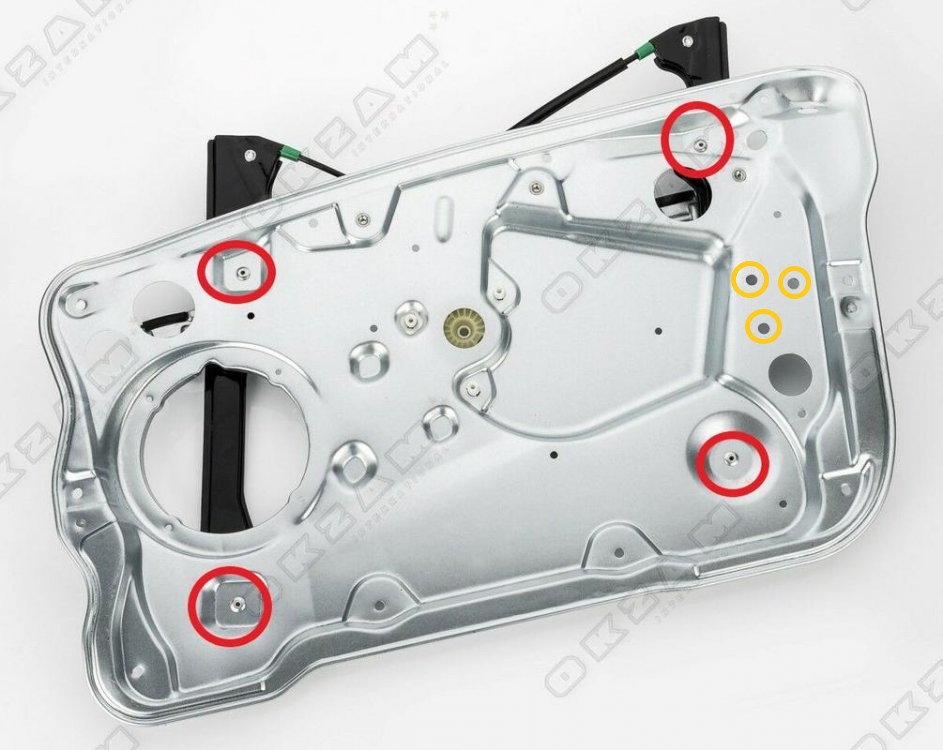

Once the door card is off you will need to drill out the ten pop rivets holding the metal ancillaries panel to the door. And because the window is trapped in the door you will need to drill out the four regulator rivets otherwise the panel will not come off.
Regulator rivets shown in red circles...

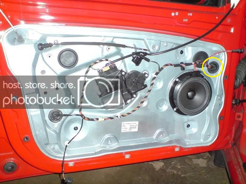

You have to disconnect the loom from the lock unit inside the door and also disconnect it from all the items on the metal panel and remove any clips etc. Then you remove the loom from the panel by pushing the grommet inwards through the hole I have marked in the yellow circle in the photo below. Then feed the complete loom through that hole....
And no problem :)

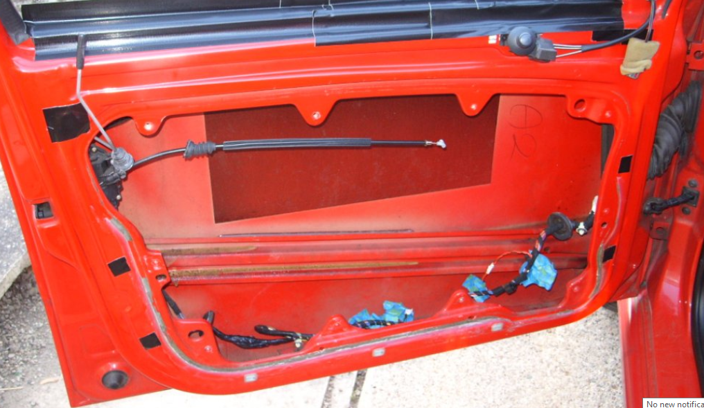

This was my loom lying in the bottom of the door (the blue bits were just tape I put over the connectors)...

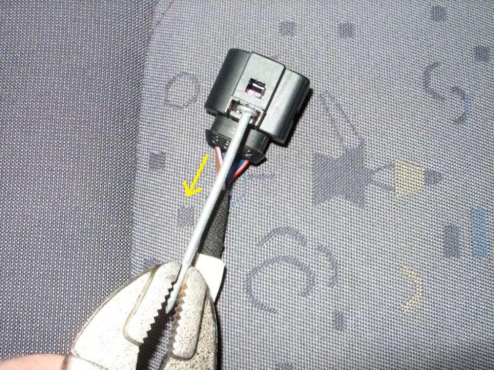

Getting the connector plug of the door lock unit inside the door can be rather 'challenging'. I found that using a pair of mole grips and a nail with a protruding head worked to pull the tab down on the plug as it's very difficult to get your fingers in....
