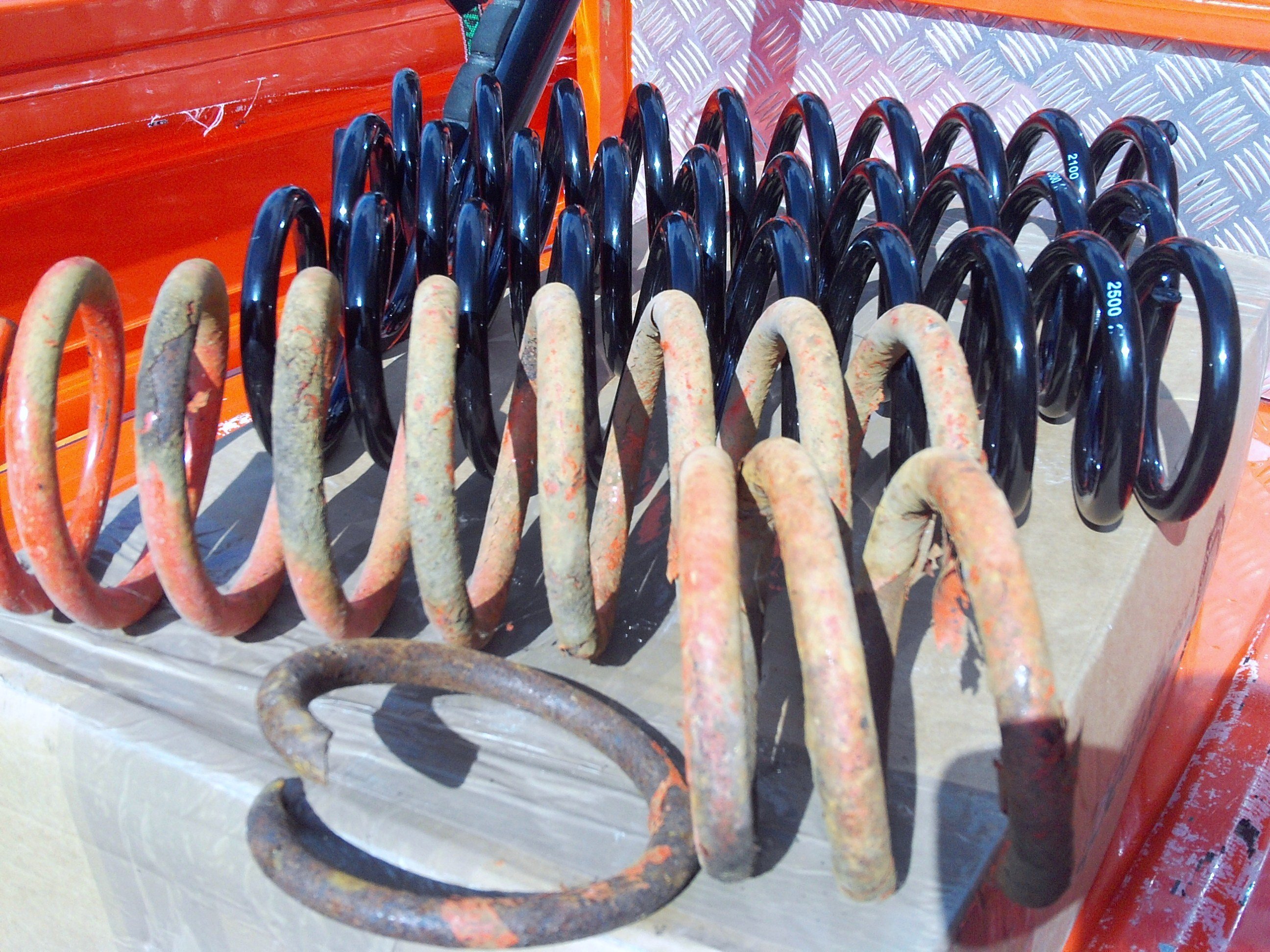

I had a spring explode outside once on an offroad truck that has sat all winter and the piece that was fired off damaged another car.
They were big springs....
