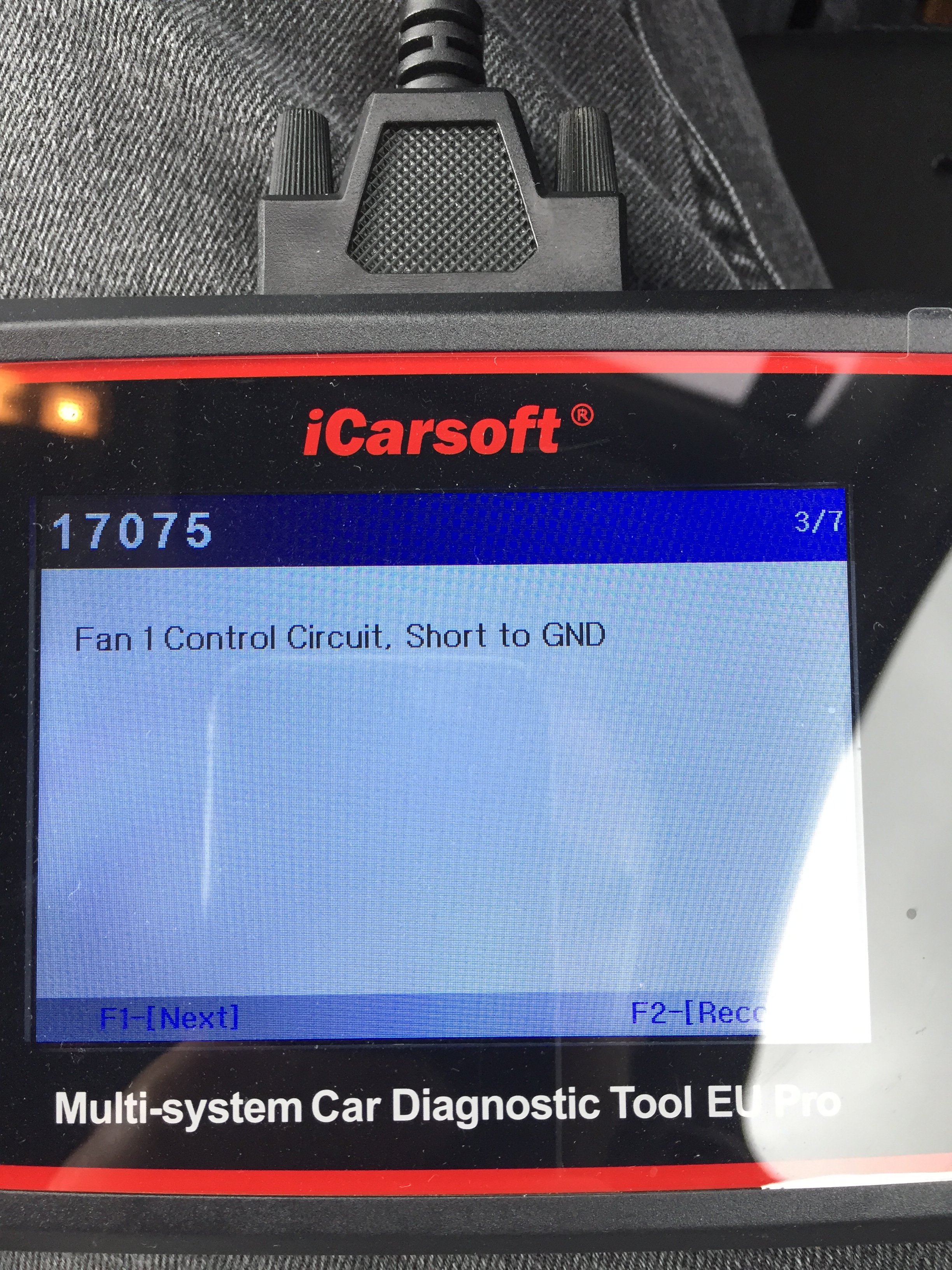

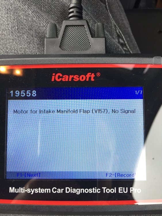

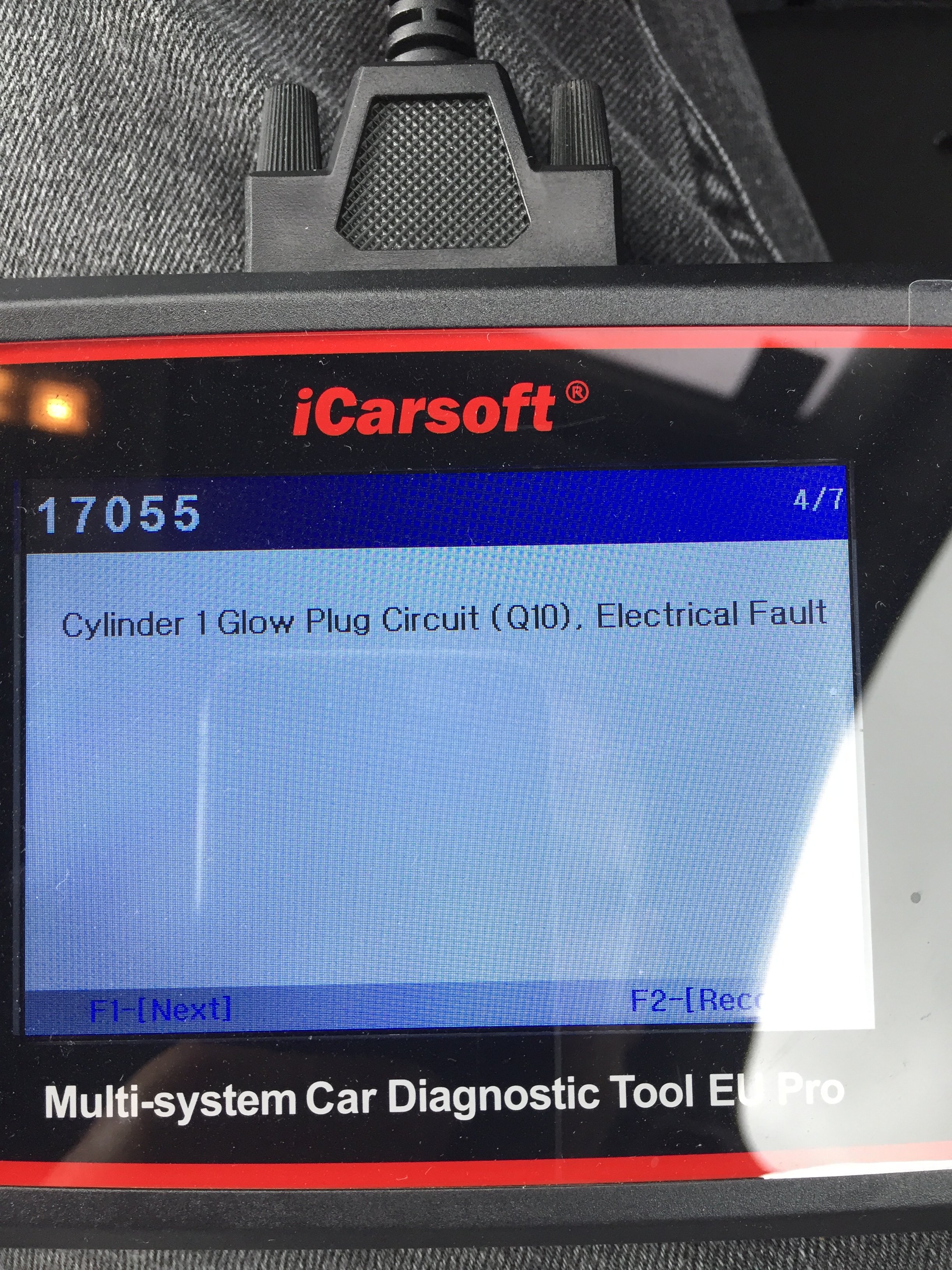

How do I go about sorting this?

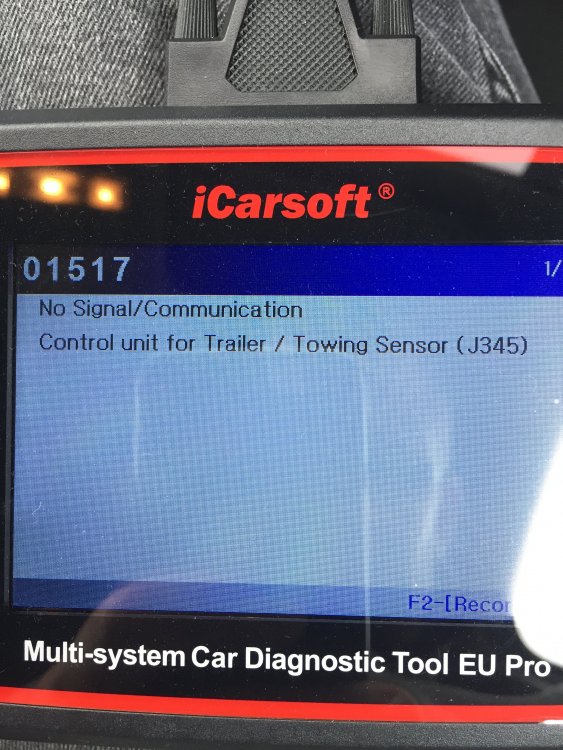

And these?

19557 and 19558 are likely related: http://wiki.ross-tech.com/wiki/index.php/19558/P3102/012546
17075 is probably similar to this: http://wiki.ross-tech.com/wiki/index.php/18068/P1660/005728
17055 might be a dead glow plug: http://wiki.ross-tech.com/wiki/index.php/17055/P0671/001649
01517 could be coding or a poorly fitted trailer module: http://wiki.ross-tech.com/wiki/index.php/01517

Regsrding the parking sensors, the tow hitch is well out of sight of the sensors, as it is connected under the bumper. Also, they were working when I first got the car, but do you think it’s worth removing it?
I doubt it's the hitch itself, more likely that something wasn't coded correctly when it was fitted :)
