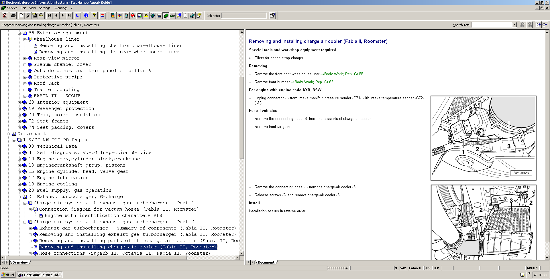

What is the full title name of this program/app "workshop repair guide" and where we can get/download it.
