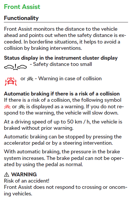

4) Front assist, I’m not really sure what I am or an not getting with this. I’ve set the option to early and it will flag up on the dash that I’m too close, but I’m not sure if it’s doing anything else, at one point I was convinced that it forced a set distance between me and the car in front and wouldn’t accelerate until that car had increased the gap in front. I’ve tried again and I could keep driving until I hit the person in front, or least that’s the impression I get and as daring as I dare test it. It isn’t equipped with ACC. And weirdly apart from the small symbol, I don’t get an audible signal.

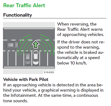

5) what’s “rear assist” or something to that effect. It shows up on my centre instrument display but have no clue what it does.

4) If you're getting the distance to the car in front warning on the dash then you have the full colour central display. The lower spec models only get a black and white screen, and so this visual feature isn't available. Front Assist will actively apply the brakes for you.
If you get too close and the car thinks you're about to hit something, whether that be another car, a pedestrian, a reflection, or a crisp packet it'll slam on the brakes.
More often than not though it will offer you an audible warning and a big red image on the screen. If this is ignored, and the obstruction is still not being avoided the car will intervene by applying the brakes. Sometimes you get just the symbol on the dash, sometimes it beeps too, I've no idea why, especially as the manual makes no mention of the audible warning.
Mine was over sensitive, so I turned it down to the least sensitive setting.
It won't maintain the distance between you and the car in front, you only get this with the Adaptive Cruise Control (ACC).
5) Rear Assist or 'Rear Traffic Alert' is to help you reverse out of parking spaces when visibility is impaired. It'll automatically apply the brakes if it sees an approaching car or pedestrian that you might otherwise have missed in your blindspots...

 My 6) was a poor explanation, but you did give the right answer with the image next to “warning risk of collision”. Very strange thing to see with little
warning and no traffic in front of me, it didn’t brake and went off before I could properly make out the image. I have heard about it being quite sensitive in the way you describe, something I’m not looking forward to and have set the messages to “warning: early” option.
