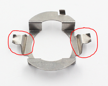

I need help and advice regarding refitting my H7 bulbs back into my mrk 3 Superb.
I unclipped them easy enough and replaced the bulbs, however I cannot seem to get the bulbs back into the headlight housing... Is there any tricks etc that could help?
Cheers
The two prongs on the base of the bulb holder only insert into the back of the headlight one way.
Take the new bulbs back out (to avoid the constant knocking against the back of the headlight) and try all the different configurations.
Once you find the correct one remember the orientation of the electrical connector, with the bulb holder done and undone, this helped me.
These are the lugs you're trying to line up...
Edited by silver1011
Thanks for the reply and assistance. Managed to resolve, turns out it was just massively fiddly, which was made worse with my big hands!
