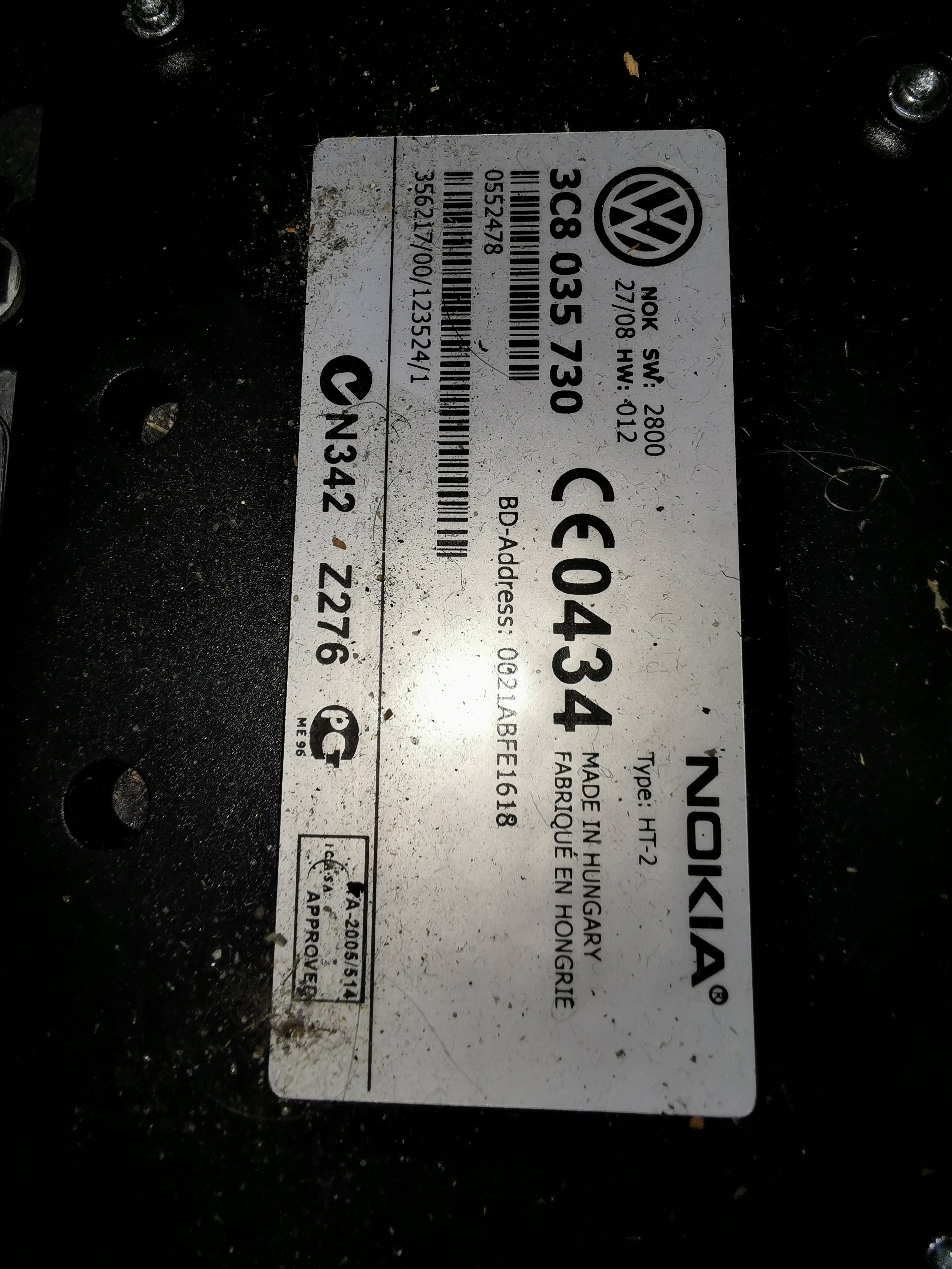

1. Some of the experts here will want to know the precise bluetooth module. You have said "3C8035730" but I think there should be a letter at the end of that. That letter can be used to tell what the module should be able to do.
2. Search the forum for android head units for more info on that. Dont rush to do this over RSAP though - a second hand module/later revision from places like eBay can deal with that and they can be swapped easily.
As far as I can tell, older ones don't have a letter. I attached a photo.

I know it  - you got caught out a bit because you car is an early one (congrats on that by the way!).
Later cars got modules that were fine with "normal" hands free mode (Like your wifes Fabia, my 2014 Superb is fine with any phone, RSAP or not).
Someone here recently had the same problem connecting an iPhone, which doesnt use RSAP either. He got hold of a 5K0035730D bluetooth module and that worked for him. You want one of the VAG modules that supports HFP and you should be fine. The 5K0035730D often pup up on eBay for €70 to €80. Not cheap but not a crazy as the rarer part numbers.

Cheers Robin, the newer ones aren't RSAP enabled, that's what I wanted to hear. I didn't want to buy a new one if it was still RSAP.
I just ordered a newer one, 5K0035730E was on ebay for €100, so just bought it. I'll worry about coding it later! Searching for that part number here gives a bit of info on coding it.
