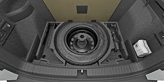

My Karoq 1.5 has the temporary steel space saver 215/60 R16, I transferred it over from my previous Karoq. It raises the boot floor almost to sill level, and comes with polystyrene storage boxes for the boot floor to rest on. I think the kit must come with a new boot floor, because it has opening flaps each side to access the storage compartments, and a longer centre spindle to secure the wheel.

Yes no space between my 125 spare and the boot floor so assume the 215 kit must have bits for the boot floor to sit on. Can just about make that out from the crappy picture on the configurator!
Helping with the picture above
