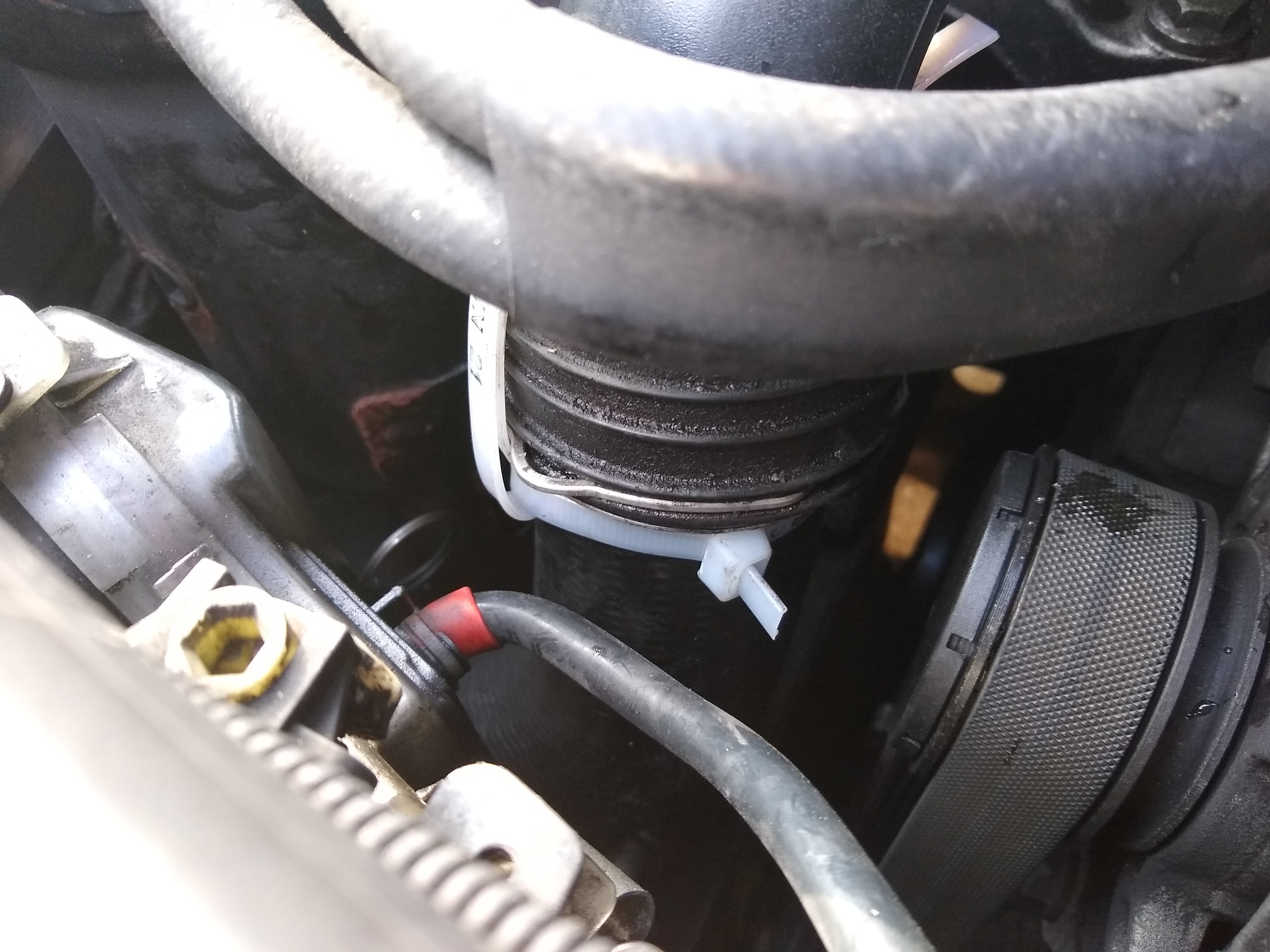

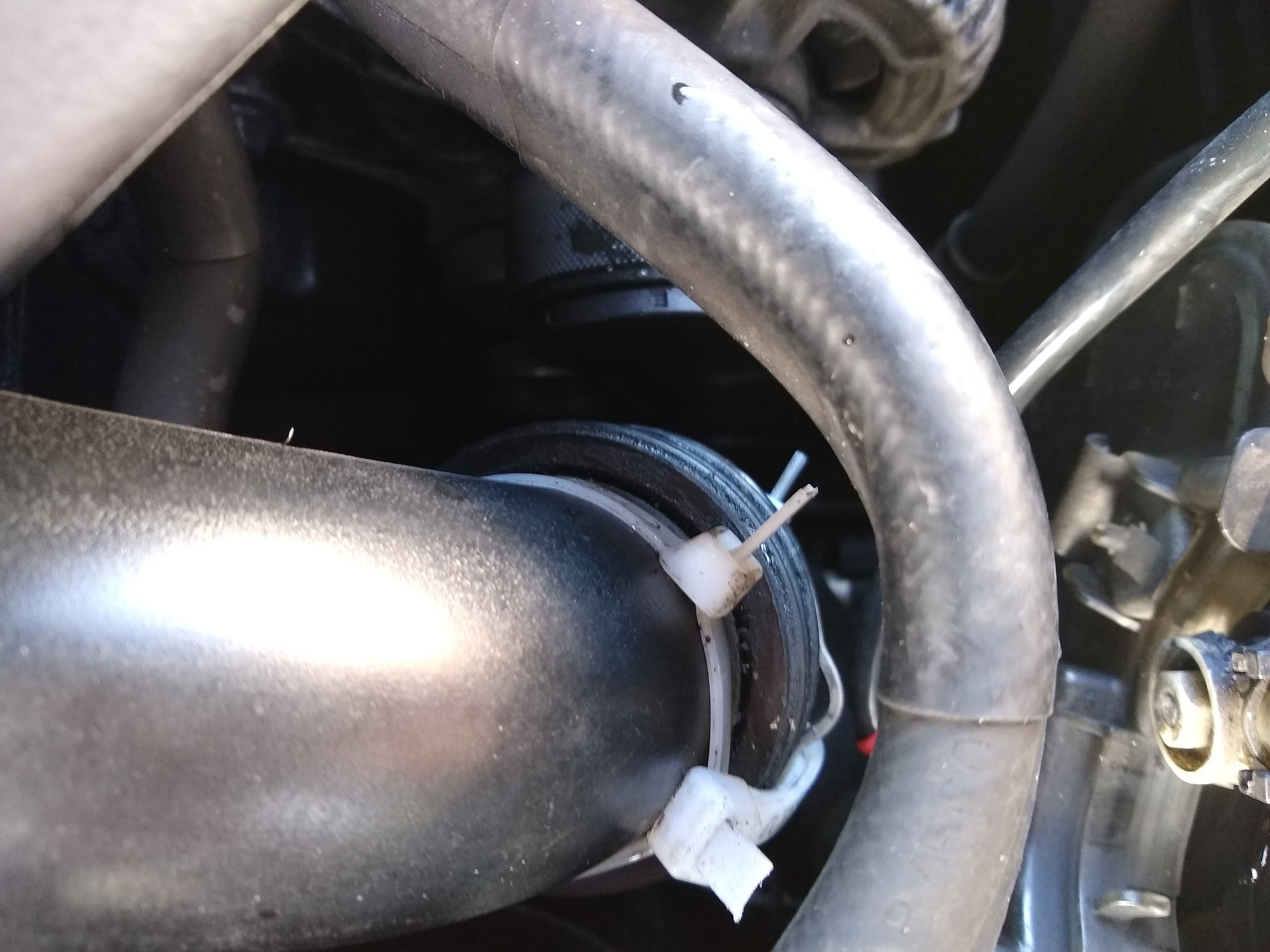

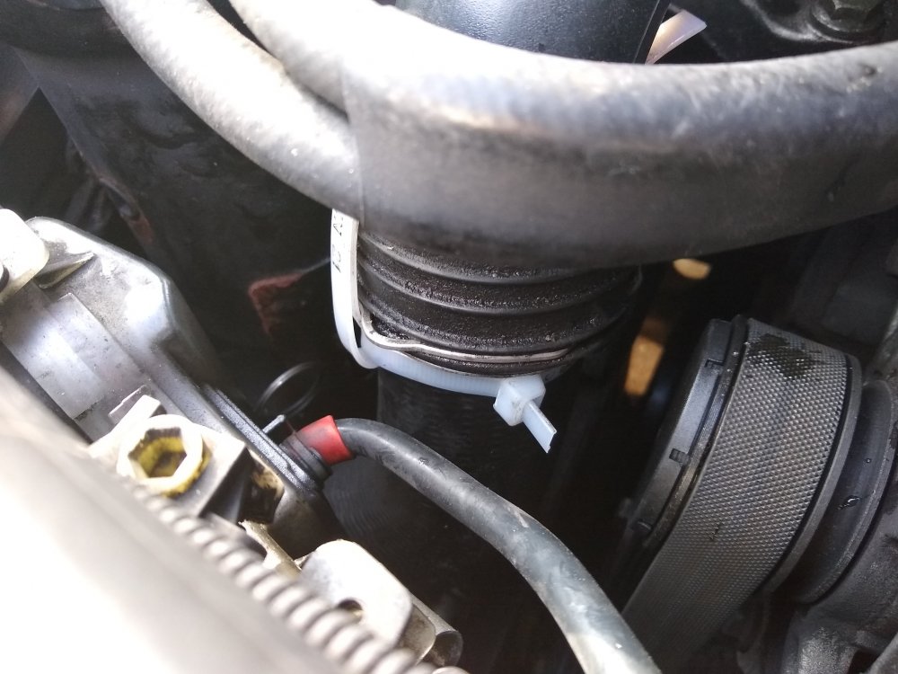

Had a longer play today, ended up zipping up the cable ties a little more. They get warm and bend more easily. A bad and a good thing.
 - They allowed the pipes to drift apart a little.
 - It was much easier to pull them a little tighter.
Also, my zip tie method is flawed. In amongst faffing around getting the ones around each pipe positioned, I failed in positioning the heads of the joining ones.
For next time.... Ideally, the headed end of the tie is at the bottom, allowing a pliers or grip to pull the long end through and up. Also,  make sure there's little slack at the bottom end behind the head. The connection should be around the mid-point once fully tightened.
J.

Update to this.
The pipes worked partially loose again within a week. But not so loose that I could manipulate them back into place.
I ended up cutting both of the connecting zip ties off.
Then used three new zip ties and pulled like a dog to get them tight. With the three zip ties, there's no sign of movement from the joint after a month.
