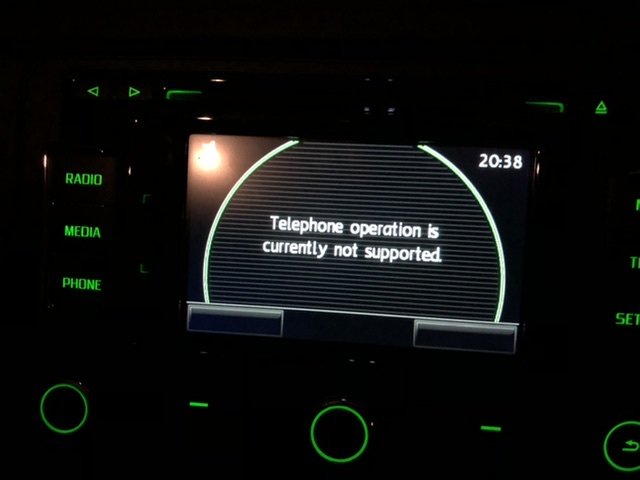

All I get is a message on the screen: 'Telephone operation is currently not supported'

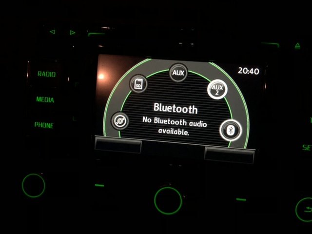

'No Bluetooth audio available'
Everything turned on phone in range Bluetooth on etc.......
Just try this on your. Mobile phone Go into settings and switch on flight mode for 10 seconds switch it off and ty to connect again sometimes this works  there isn’t a known reason for it to work .
Not sure if that's an Amundsen+ with an integrated BT module or an Amundsen with an external BT module.
Assuming the latter, I'd check under the front seats for a BT module and try unplugging it, waiting 10-15 seconds and plugging it back in.
