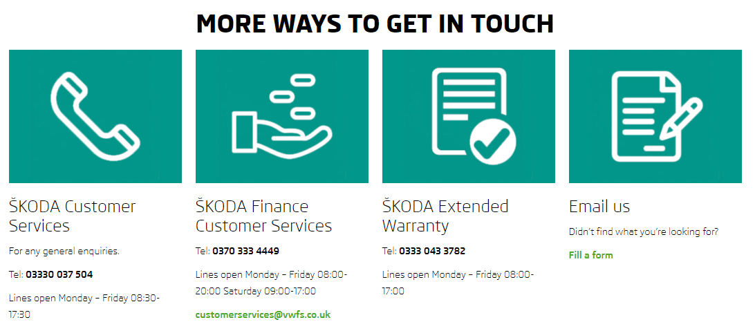

The only way to know for sure (and even this is debatable), is to contact Skoda UK direct, quoting your VIN (the number visible through the windscreen under the passenger side wiper blade)...

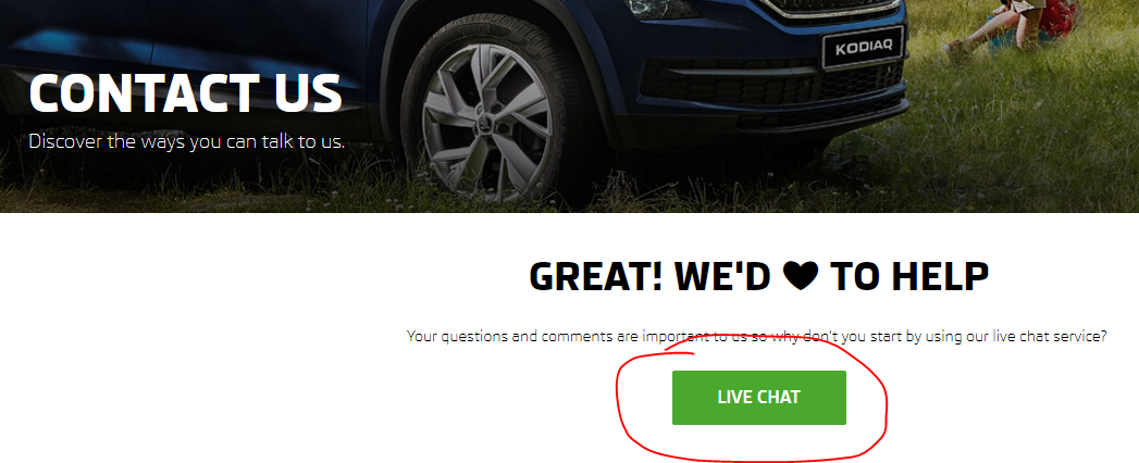

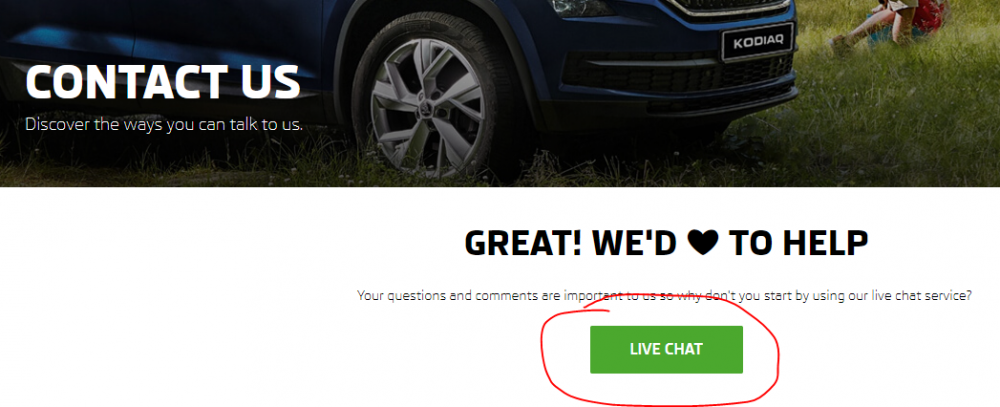

Or, for a faster answer, try their live chat function...
They'll try and palm you off to your local Skoda retailer (dealer), but just tell them you've had conflicting information, and you'd like to have it in writing from Skoda UK.
