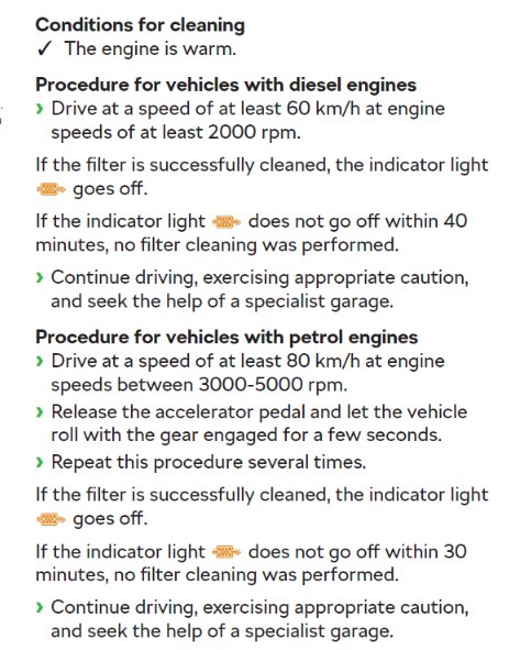

Your understanding is pretty good  John. There is no regen on a GPF in the same way as there is on a DPF. It isn't required. But when/if a partial blockage occurs the procedure above should be implemented. During the procedure some tiny amount of ash does get ejected, but mostly all that happens is the debris gets a good shake up which unclogs the filter, allowing the ash (which is mostly harmless) to settle in a collection chamber. It will take a car lifetime to fill this area for most people.

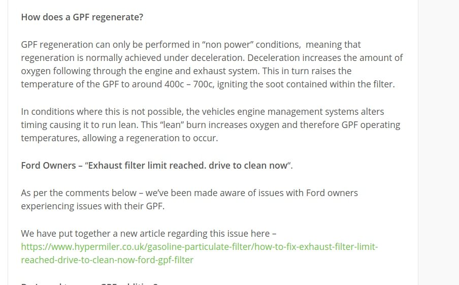

This is from the Hypermer.co.uk website linked earlier.

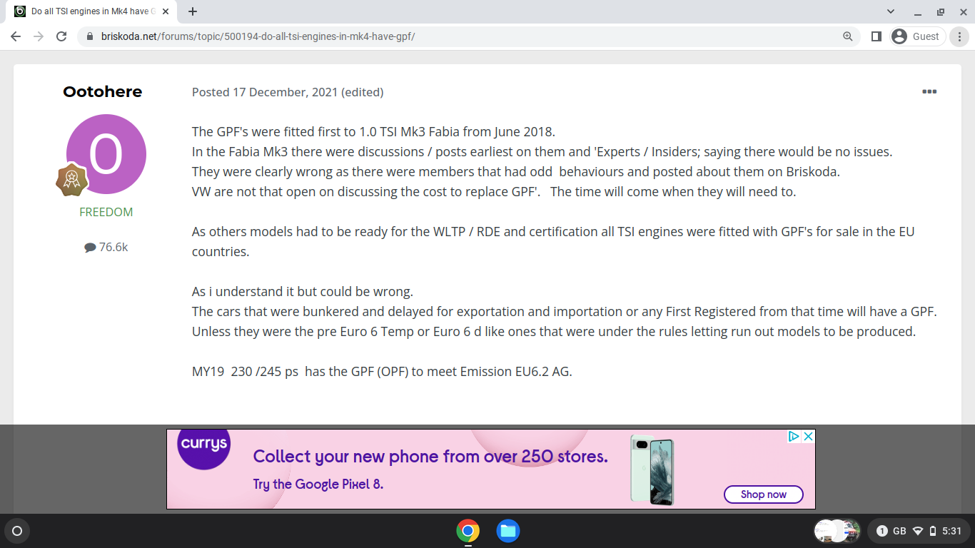

@Warrior193  I bumped for you to see.  Are you sure her car has a GPF if built or first registered in 2017?
Hers is 2018, but the information I have is that they started fitting GPF to the 1.0 TSI sometime in 2017.
@Warrior193  I can and am often wrong, i might be again. But i do try to be up on what happened and when.
Someone can maybe correct me if they had a GPF pre summer break at the factory 2018.
Maybe they were fitted ready for September 2017 and the transition to the WLTP.
