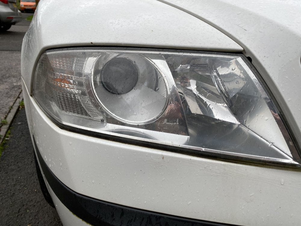

Been using this 57plate Skoda for a few months and I’ve noticed that both headlights are not very bright. Are there any bulbs that will make them brighter
Have a look at Philips Xtreme Vision or Osram Nightbreaker Laser NG, both around the same price, and quite an improvement on cheap bulbs

I would check they are set up correctly.
When I first got my car I was really impressed with how much of the road they lit up compared to my previous car.  However,  they were never the same after the dealer 'flattened' them when I took the car to France and Spain, and then adjusted them back. I requested they adjust them at every service and was told they were well within Skoda tolerance.
That's when I started using the Osram Nightbreaker original and II.  The main problem I found with them because of how they operate and I was travelling long distances, I was lucky to get a year out of them at best.  So I resorted back to normal bulbs.
Recently I've started using an independent and got him to adjust the lights,  and they are a vast improvement over what they were.
