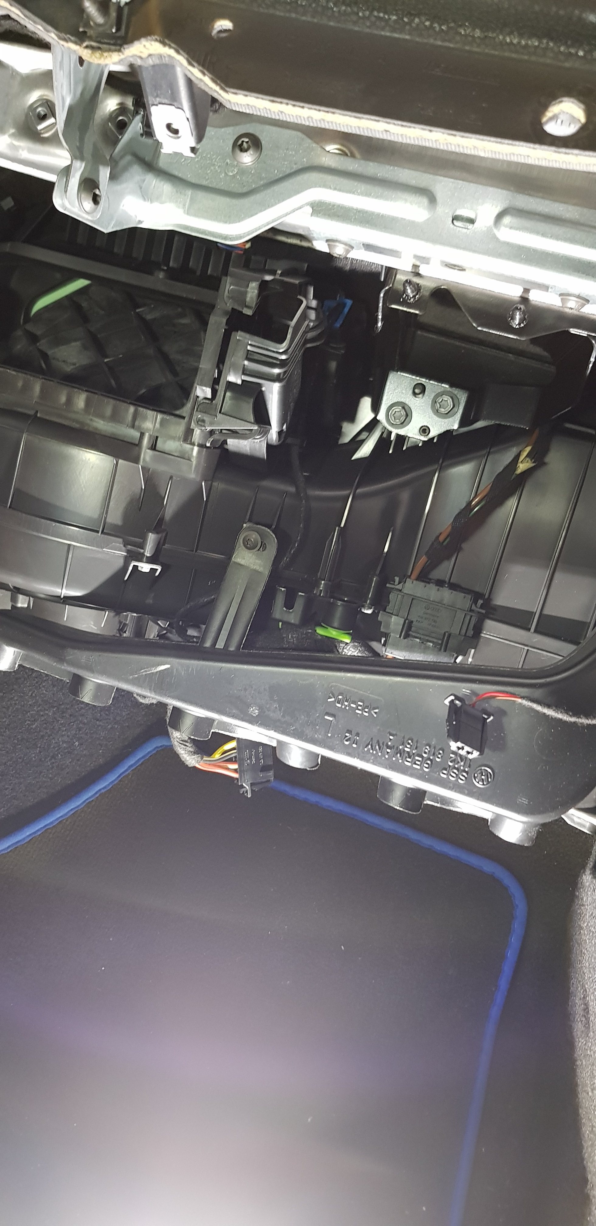

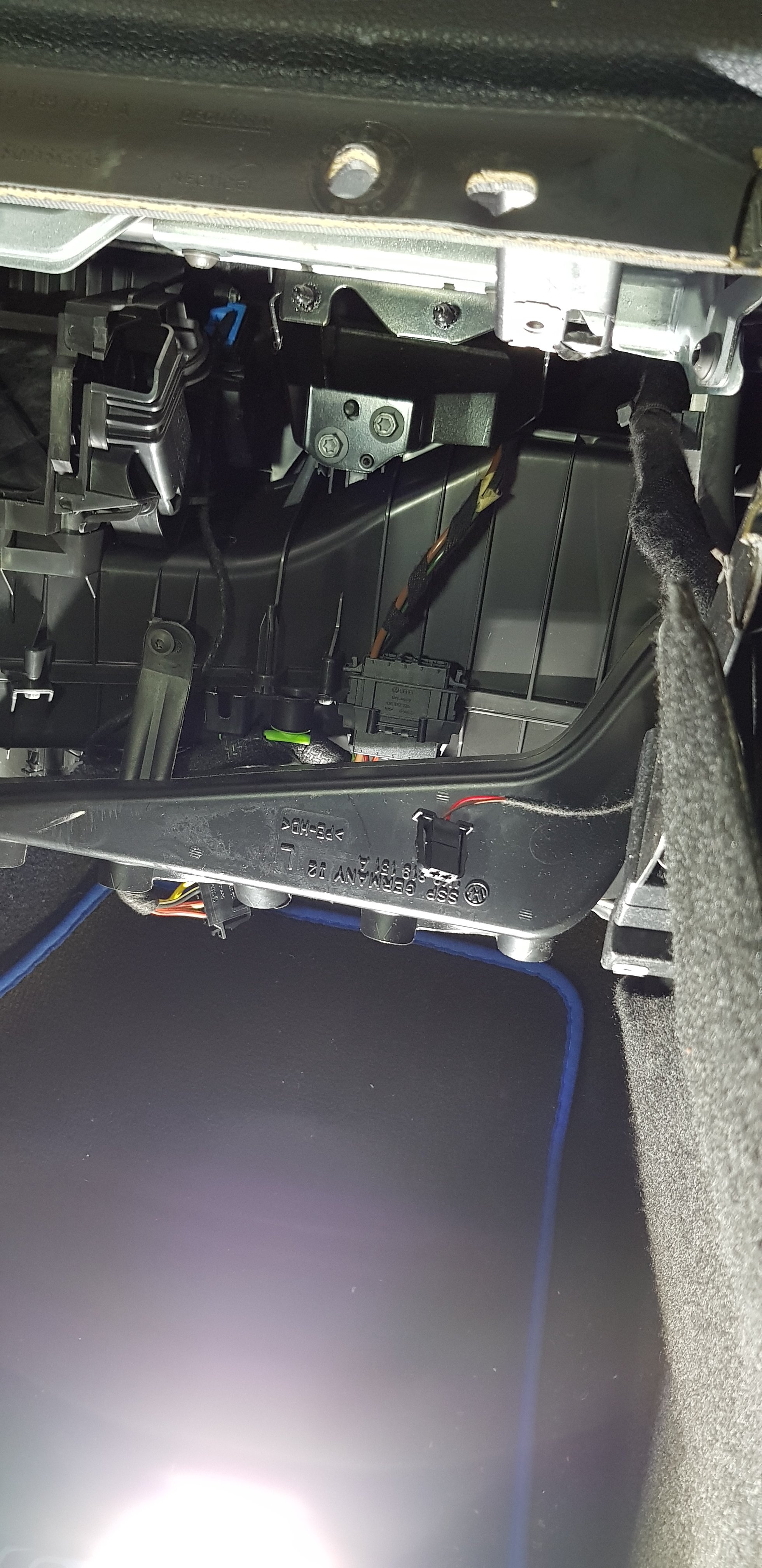

 With the help of a friend we removed the glove box, SRS switch and removed the stereo and had a good look at the wires and could not see any wires that were chaffed. I am attaching two images which I took. We removed the plastic bit that blows the air out to give full access to the wiring loom. We could not see anything, everything was wrapped with tape. I was really hoping this would solve my problem with the heater 😞 ....search goes on...any help would be appreciated....
Hi Dabbs,
if there are no cheffed wires the only thing I can suggest is thorough continuity test as I did before taking everything apart. While yours is dissassembled test continuity from the supply side from the fuse to the power in pin of the four position speed control. Check continuity through the switch itself on on all positions. Check continuity from each supply position from the switch plug pins to the resistor plug pins. Check the continuity through each resistor path in the resistor block itself. Do an independent 12v supply to the fan and see how it runs. Check the fuses! I'm sorry if any of this is teaching granny to suck eggs. Other than what I have done I do not know Ifwhat else to suggest. Er, the current draw of the fan should not exceed 30 amps.
If your fan has not worked since buying your car I do wonder what else there might be wrong electrically. A lot of components run a common fuse, eg. the reversing light switch and oil level sensor. mispositioned fused is another common finding. I can't give any more ideas as to what you should do. Good luck.
