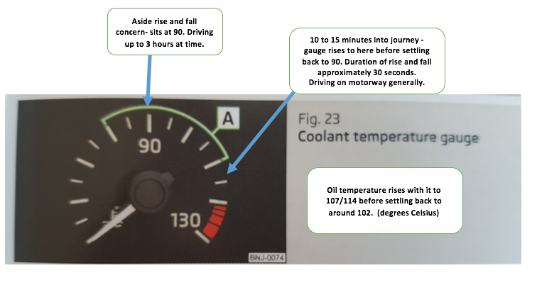

Temperature Gauge Behaviour?
Any thoughts on whether or not this is normal behaviour for my diesel? 35,000 miles.
Fabia Monte Carlo TDI 1422CC 2016 model.
All info in picture attached.
"A" is meant to be operating temperature every car I've owned has stuck at 90.

Thanks for your replies, although I thought it was normal behaviour I took it to the dealer under warranty and they have informed me today that the water pump is failing and needs replaced.
