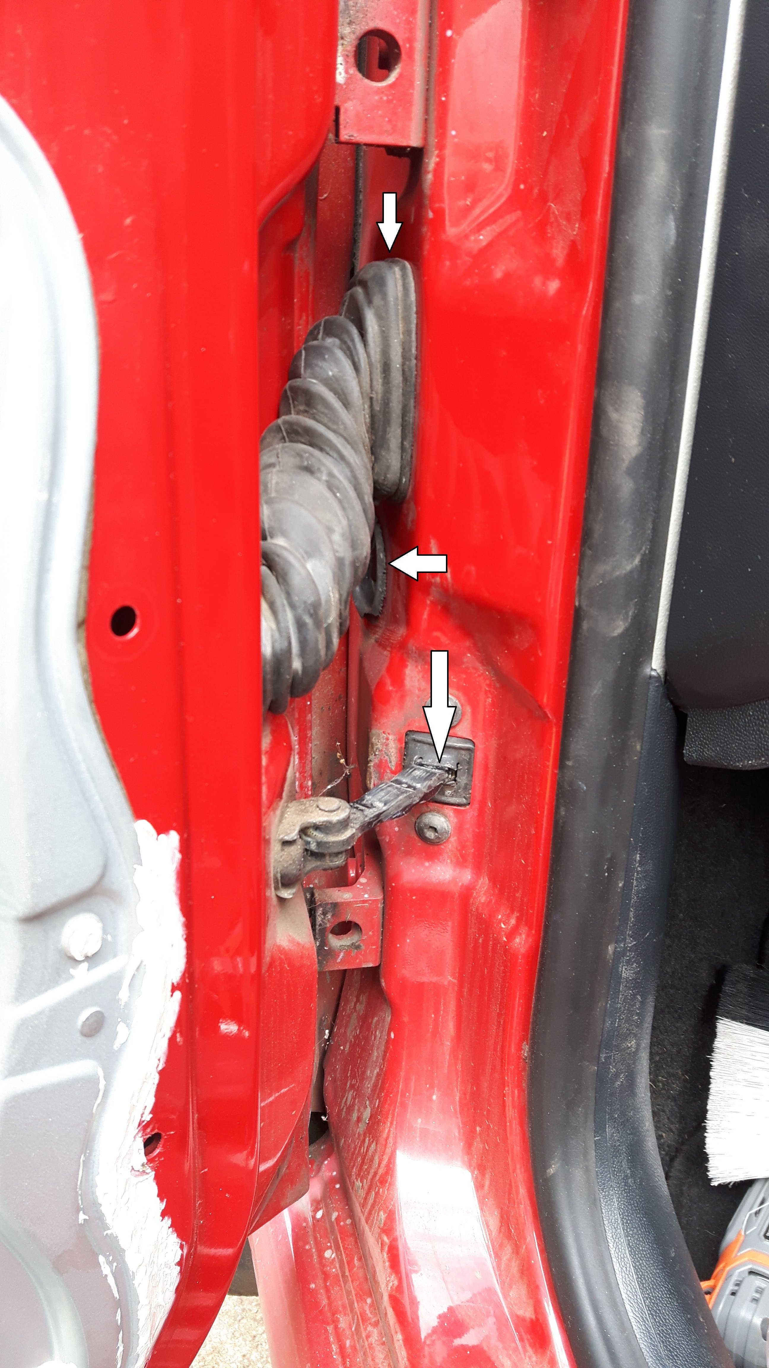

OK, have you looked at these three possible places for water ingress:
It may be worth adding a little sealant to the upper two of these just to help the rubber grommets seal fully. It's very hard to tell if the upper one is properly seated behind the bellows, unless you can get the white part out fully that it clips onto and then refit both together. The risk there is breaking the retaining clips of the white part and making the situation worse rather than better.
I'm not even sure what the middle grommet is for below that, but check that it looks properly seated.
The check-strap gasket is something another member posted about recently. He could reliably get water to go into the a-pillar by wetting that. I'm not sure if the normal drainage path always goes across that one, but it probably sometimes does depending on the angles that the vehicle is parked at.
Having said all that, if the leakage path was through the A-pillar, I think you'd see evidence of where it was coming out of the a-pillar into the cabin.
I wonder about the aircon condensate drain, and where water would go if it wasn't correctly attached to the evaporator housing?

The bellows/harmonica sleeve is not connected properly, and the white plastic housing behind isn't either! It seems entirely plausible that water could drain down and in that way.
Oh, I am at the same time overjoyed at possibly having found the solution and angry with myself for a) not finding it myself and b) not posting here sooner. Any tips for reattaching them properly?

I haven't ever removed the white plastic part, but if I remember rightly there are two or three locking tabs down each vertical edge that would need some sort of hooked tool to release.
Some of yours may be broken, as it sounds like a repair of some sort has happened in this location previously on your wife's car.
Once released, I think it would be easy(ish) to attach the bellows properly to that white part, and then push both into place.
@TMB's image in this post in  a recent thread of mine shows the two locking tabs on the nearest side (can't tell if there's a third higher up, out of shot):
