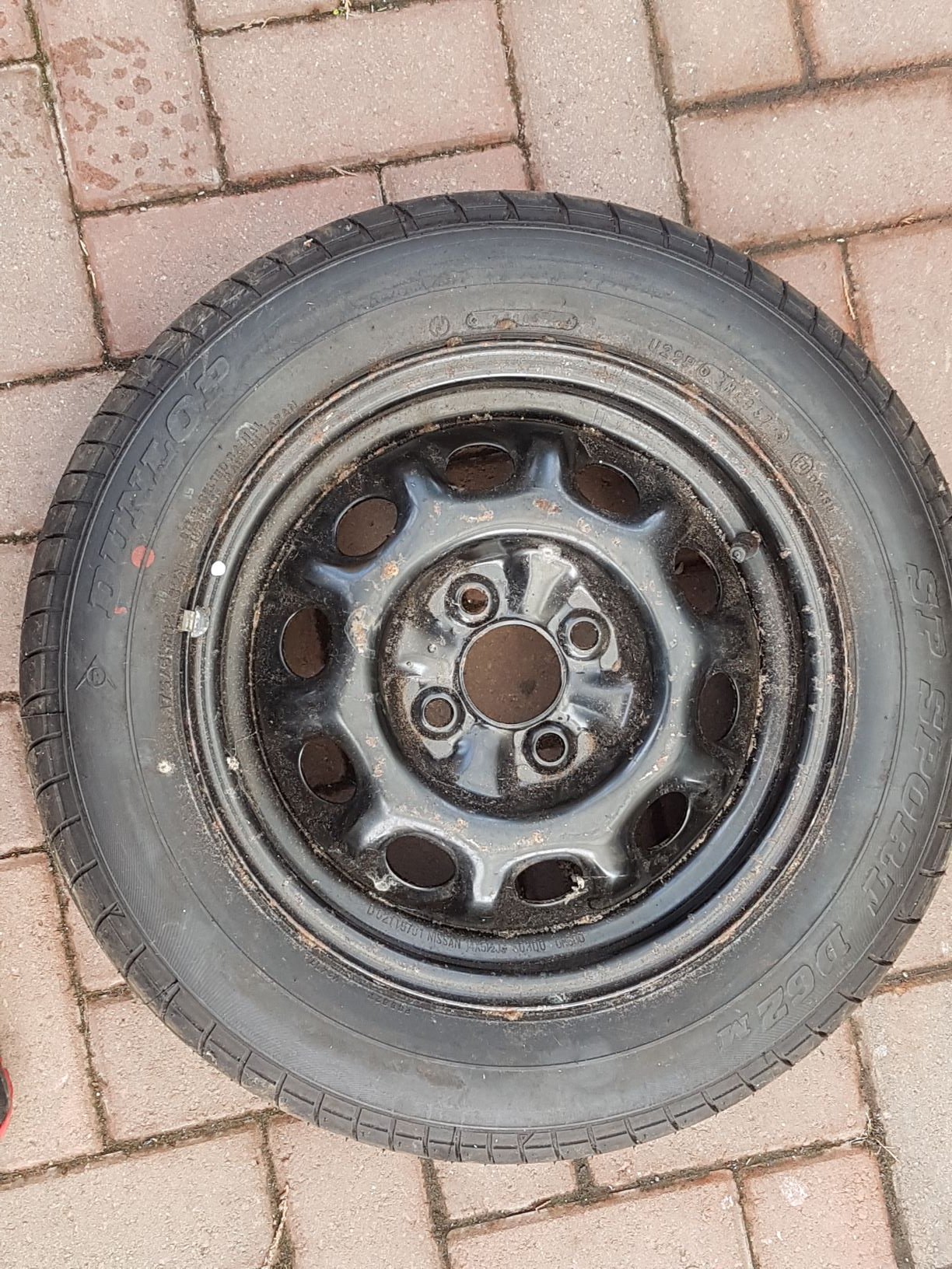

Does anyone know what vehicles this wheel fits, or recommend a website that I can use to find out?
From what I can see on the wheel it states the size is 14 x 5 1/2 J.  The tyre is a Dunlop Sport D62M 175/65/R14.
i know it is stamped 'Nissan' at the beginning of the wheel size, but my neighbour has a Ford Fiesta and was wondering if she could use it as spare.
Many thanks,
Fin

You'll need to know the pcd (diameter of the bolt pattern), number of bolts and whether tapered or round bolt heads and the centerbore diameter.
Then if that's all ok check if the wheel will fit over the brakes and that the offset isn't too far out.
Ah, it would appear to the layman to be a little bit more complicated than he first thought.
The wheel was left behind by the previous occupant.
I'll see if one of the local garages can make use of it,  otherwise I'll have to pay someone to dispose if it.
Pity.
