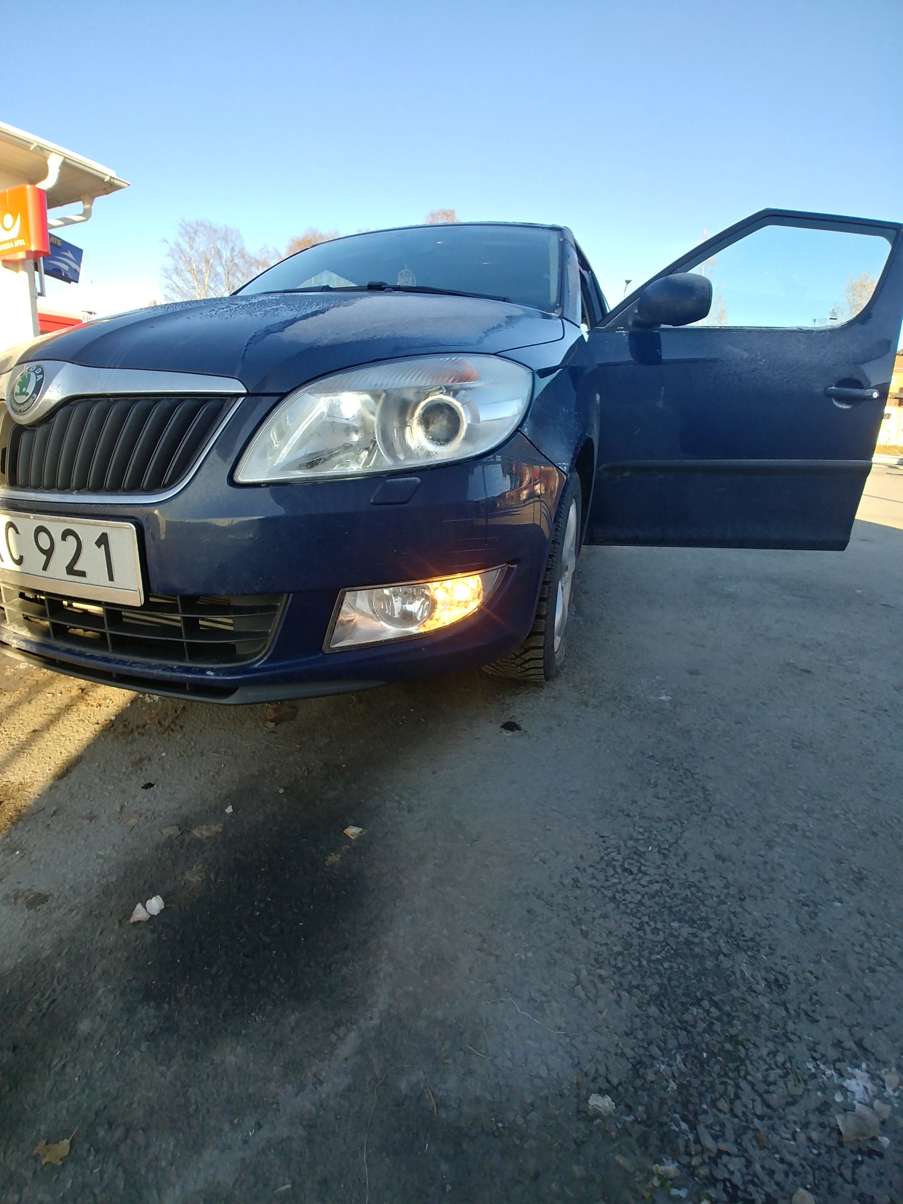

I have a Roomster 5J from 2012 with the original DRL/fogs fitted and yesterday the driver side bulb decided to die. I replaced it as I have done before and now both sides are dead.
Bad / Broken bulbs? No, I fitted the new one in the turning signal and it works...
Fuse? I don't know. Isn't it the same fuse as the radio? Don't have the number in my head.
The fogs works ...
I don't even know where to start looking for errors here.
All advices are appreciated.

Today I measured the lamp socket with an VOM Multitester and nothing. Dead in lamp socket. So I replaced the fuse with a new one 7.5A, and now it works.
This is so strange as the old/original (?) fuse is not burnt.
