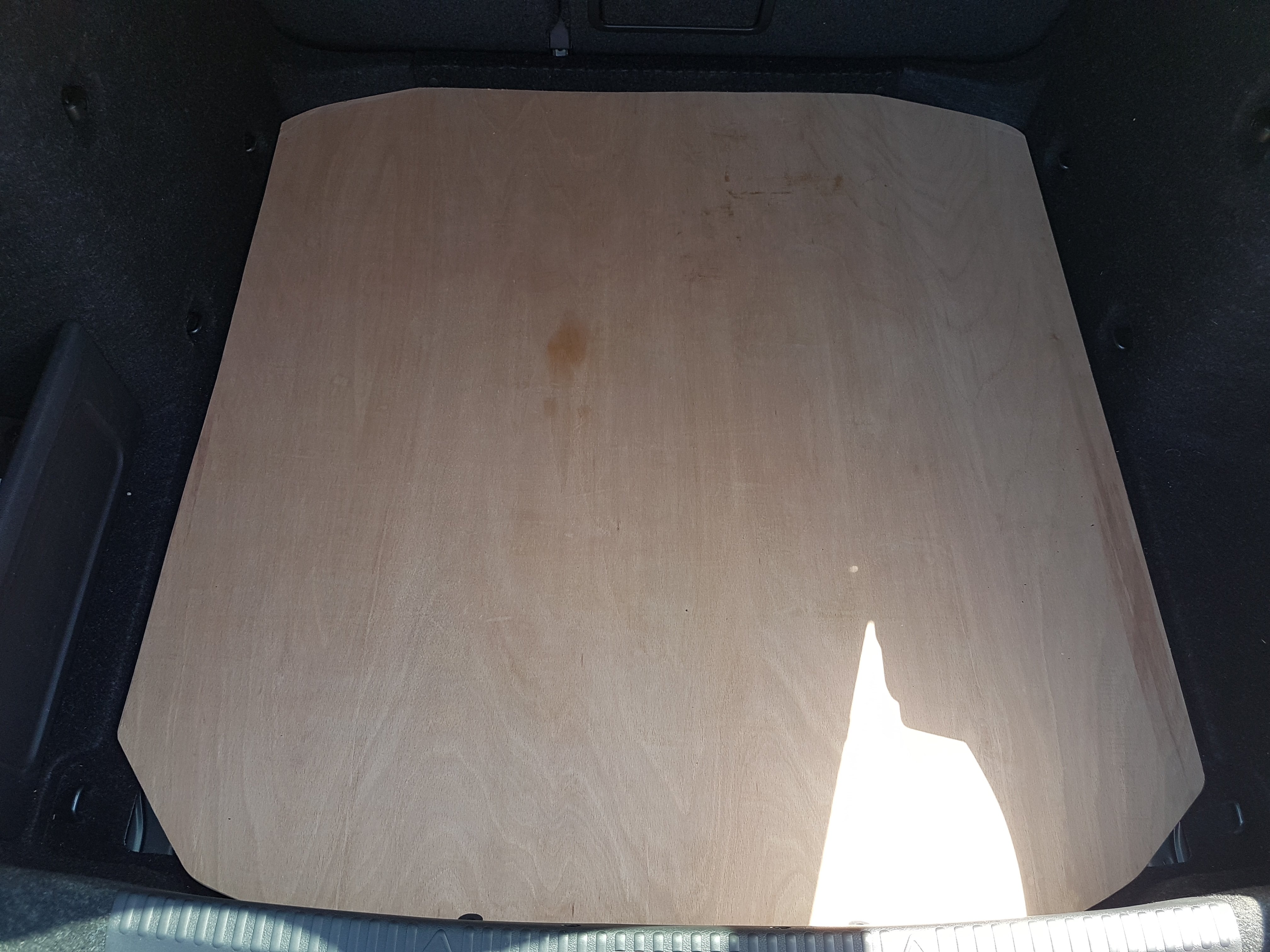

When I stuck a space saver wheel into the boot space, it does of course leave a gap of space above it between the cover and the wheel. A weakness if like me you sometimes carry heavy scuba cylinders and the like. They could break through the floor and into that space. The remedy was simple, make up a piece of 5 ply to the correct size and lay it down in the boot. Good and strong for any heavy items you might stick in the boot. Far better to get a spare wheel than that gunge most cars now come with though. The picture was taken in that lovely period early in the year when the sun was shining, as you can see by the bright spot on the lower right corner of the photo.

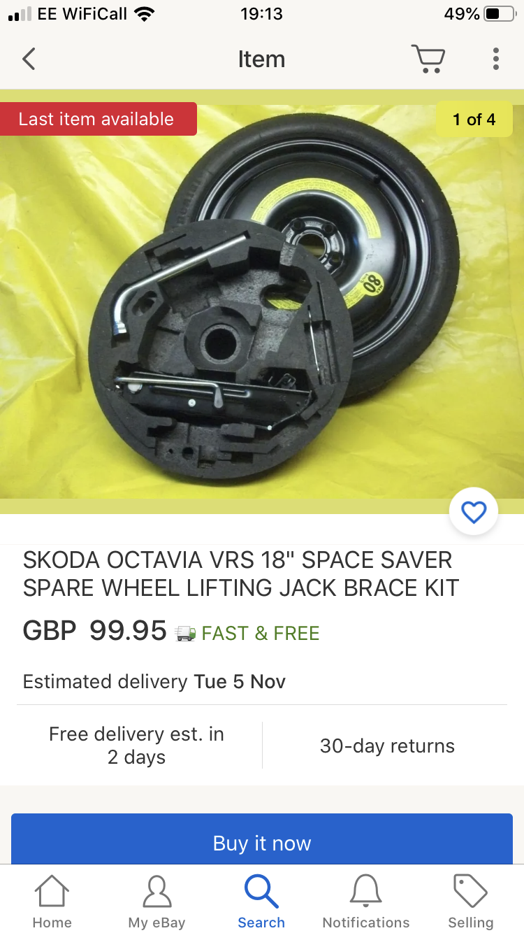

Thanks for the replies
This one?
