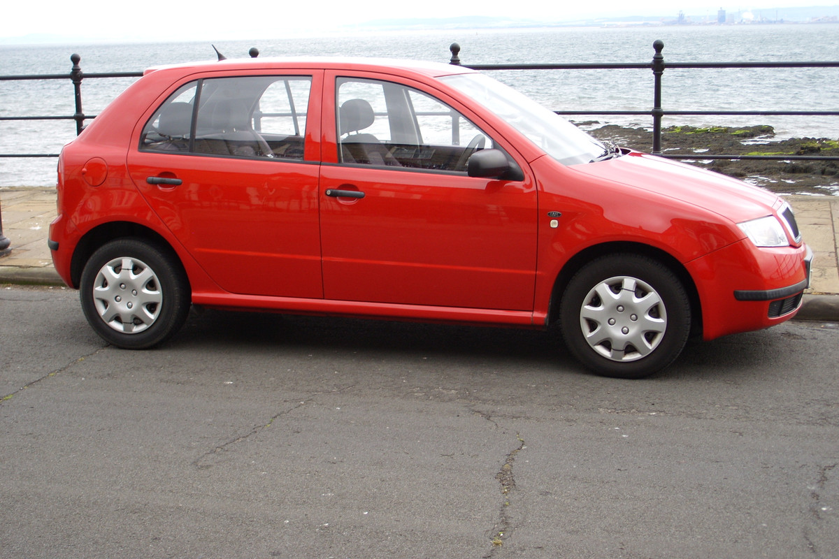

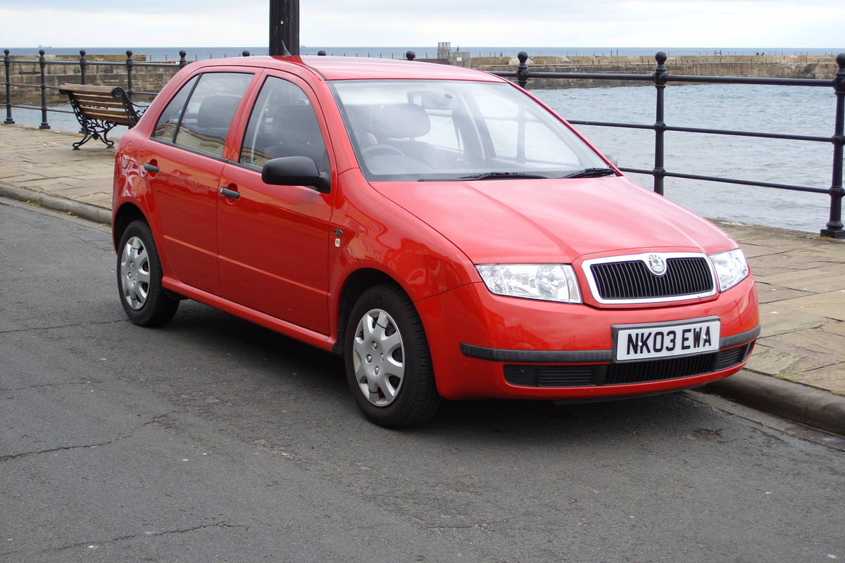

This was mine freshly done with Autoglym. Stays looking nice for a good while...
Fair play looks like a nice clean car! :) living on the coast too haha do you underseal it?

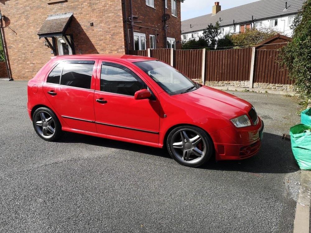

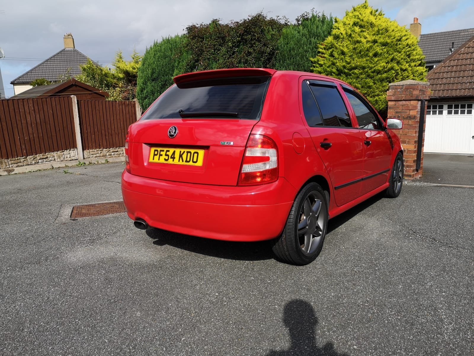

Here's mine which looks shiny but the back end is the faded culprit! Haven't got any from behind it that show the colour difference!
Yours looks really nice too :)
Yes I live right on the coast. It just has the factory underseal but it's fine underneath according to the MOT man.

Both look in really good shape for the age of them, I do like red cars, look good polished up. I wonder if the faded rear was frequently parked up with the sun on the back end. You see a few pink Corsa's and Astra's dotted about where Vauxhall have really suffered from colour fade. Nothing wrong with using the colour magic polish to restore the red, you can still use the AG Topcoat sealer over it for a long lasting finish. PE54 would be improved by black mudflaps IMO, I think they would go well and keep some of the road crud at bay.

Thanks mate :) there is a chance it was being the two only plastic panels at the back of the car.
