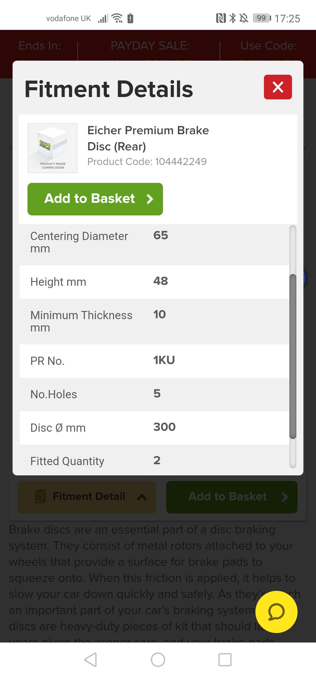

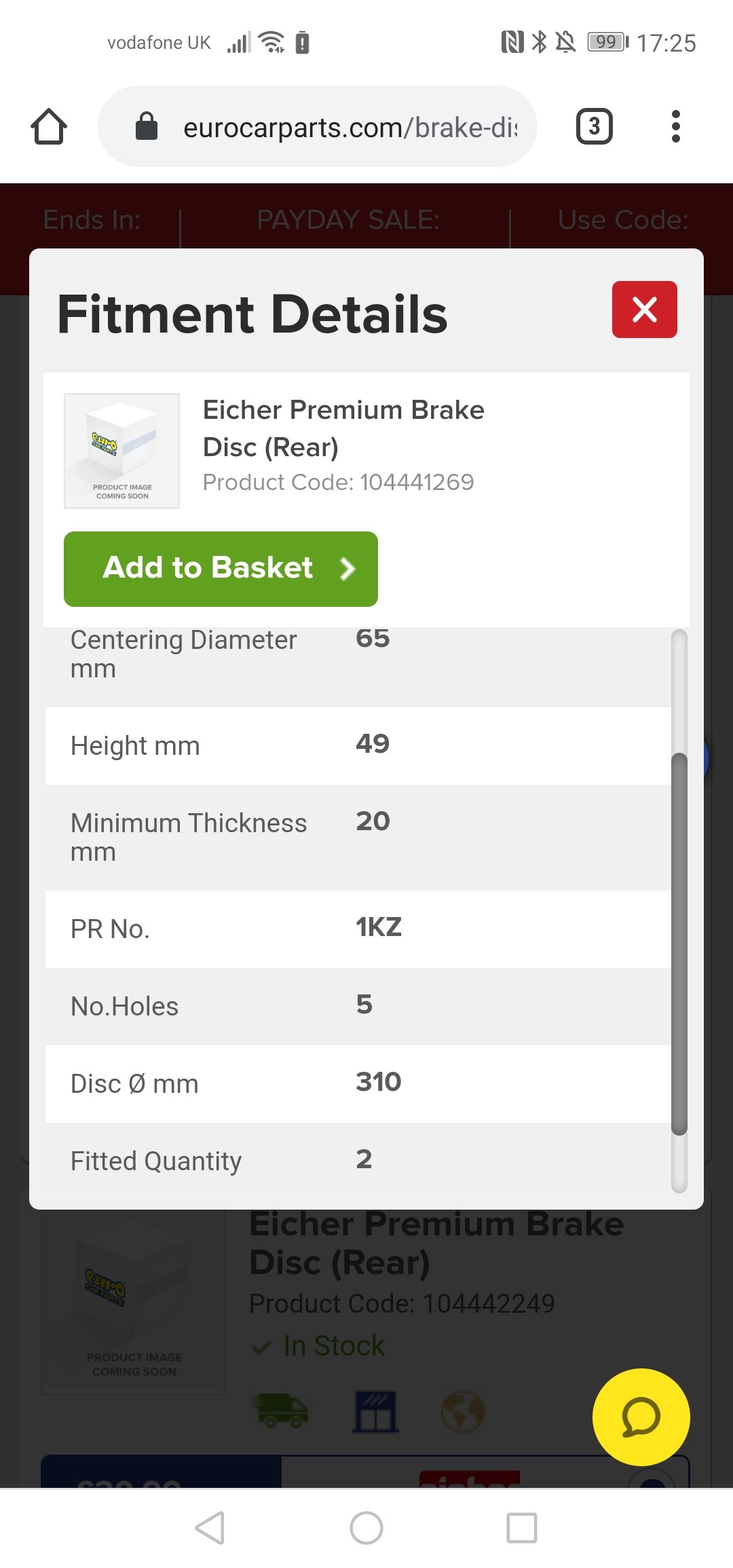

I'm looking at rear discs for my 2.0 190 tdi on euro car parts. There are 2 fitments. Anyone know what size I'd need. I'd assume the larger ones. But just wondered if anyone knew for sure. Wheels are 19" but I assume this would not have any reference on what ones I need to buy.

Have a look at the Options sticker in your boot mate, look for 1kz or 1ku👍

Ah. Turns out it's 1ku.didnt even know that was a thing. Thankyou very much that's brilliant.
