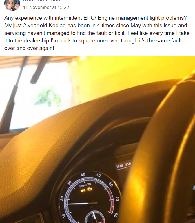

Take this example, a clear fault light on the dash, the customer has taken her Kodiaq into the main dealer who claim there are no fault codes logged.
This is highly unlikely, as soon as that EPC / EML light illuminates, in 99.9% of cases a fault code is logged...
So who is at fault here, the car, the diagnostics equipment or the technician / dealer?
