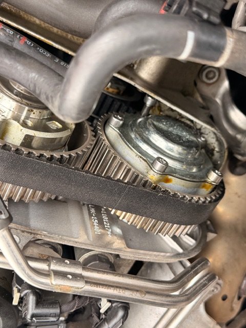

Hi - I have a VW (sorry I know) Tiguan 2018 1.4 TSI
My camshaft adjuster bolts have also come loose. VW are refusing to admit any manufactuer fault due to the incorrect torque being used. Oil and metal shavings have gone in my engine.
I'm building a case to the motor ombudman. Do you have any further information about this? I've also seen 2 other related posts and people are saying they've seen the same things too on my reddit posts.

Looking back through the thread it looks like the proof will be that no-one has touched the parts since leaving the factory.
Nothing to say it isn’t a case but ApertureS definitely had insider knowledge so if the message at the time was that after-factory work had been carried out, then that’s what was being said at the time (be it accurate or a corporate fob off)
