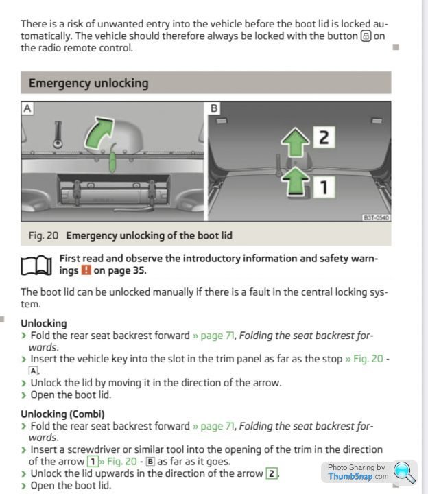

Chap on Pistonheads helped.  Boot can be unlocked from inside manually.  After that the remote worked on the boot again.

Actuator probably dead.
