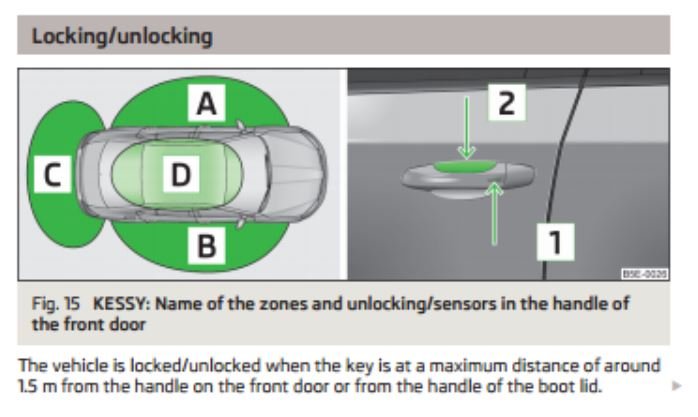

I've took this from the manual for the facelift Superb. It was also in the manual for my last Octavia
Deactivating keyless unlocking and locking › Lock the vehicle with the button  on the key. › Within 5 s, touch the sensor on the door handle with your  finger. Deactivation is  confirmed  by a single  flash  of the direction indicators. › To check the deactivation, wait at least 10 seconds and then pull the door handle. The door must remain locked. Keyless unlocking and locking is automatically activated once again after the vehicle is unlocked.
