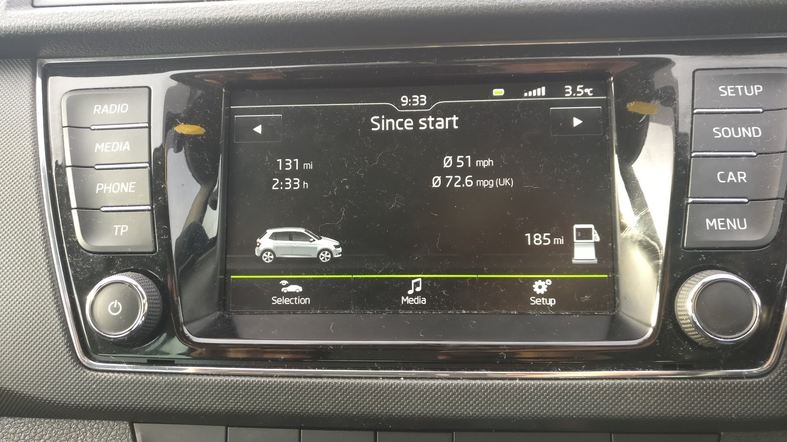

Morning,
i have a 15 plate, 1.4 TDI 90 bhp. I use Tesco fuel, i have done for the last 200k miles in my Skoda's and never an issue.
This morning i started mine i was getting after couple seconds its was idling at 1035 outside temp was 2.5 degrees.
On my run to the motorway stop a couple of times in traffic before it got up to temp and idle was still at 1035 same outside temp.
After a long run, i checked again at it was still 1035 idle, outside temp was 3.5.
Ive never had mine hunting as your say, i have had the RPM increase without touching anything sat at idle a couple of times, but its not a huge increase say from 950 to 1035. But never hunting around.
Whats the service history like on the car? Has it had the fuel filter/ air filter changed recently or due?
Any reduction in MPG? photo below is what i got, today, so could use to compare (sorry about the dust).
